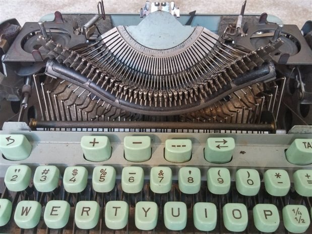

As stated in my introduction post, my initial idea was to place some sort of photo-interrupters under the keys to detect which key was being pressed. However, I soon realized that this could not fit under the top row of the keyboard image. So, I decided to go with a more basic approach. I removed the front cover of the typewriter (usually you remove this to change the ribbon). I also removed the carriage (the part that holds the paper) and the ribbon because they were getting in the way. This is what was underneath:

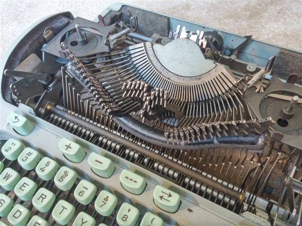

Another view with me lifting up some of the "arms" (I don't know what they are actually called in typewriter lingo):
You can see there are a lot of moving parts inside. When I press a key on the keyboard, one of those many arms will swing up and smack the ink onto the paper giving it a nice clickety-clack sound. However, when I am not pressing any keys, all 44 of those arms rest on that curved black piece. Since the arms are all metal and that curved black piece is some sort of rubbery foam, I decided to add small strips of conductive material onto the black foam part and basically create a lot of "normally-closed" switches.

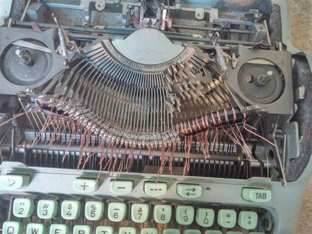

So that was my basic idea for how to detect key presses. Sounds easy enough, right? Wrong. Turns out there are many issues with this design! First of all, what conductive material could I place that is thin enough to fit next to each other without touching each other? At first I tried wrapping copper wire around the rest bar but there isn't a lot of room to move my hands around it so this was impractical. Next I tried using conductive tape but the tape didn't stick well and it got fairly difficult to even try. Eventually I realized something that would save me... It turns out I can remove that black foam part! It isn't glued in place and because it is foamy it can compress enough to escape the holds of that metal bracket underneath. Wait did I say metal bracket? Yea, that's another problem. If the bracket is metal then I need to ensure my conductive strips aren't touching that either or else they will all short together and the Intel Edison won't know which key is being pressed.
So finally I came up with this: I removed the black foam piece, wrapped 44 small lengths of copper wire around it but spaced each out enough so they weren't touching. Then I covered the metal bracket with black electrical tape. In the end it looked like this (warning, it ain't pretty):
Looks like a mess right? Don't worry, it's not finished yet. I will attach a wire to each copper "winding" and then trim off the excess copper that you see sticking out. Once I finish that, it will be just some loops of copper around the black foam with wires coming off each loop. Each wire will go back to the Edison's GPIO. Although there will be 44 wires and the Arduino breakout board doesn't have 44 GPIO's.... Hmm....image

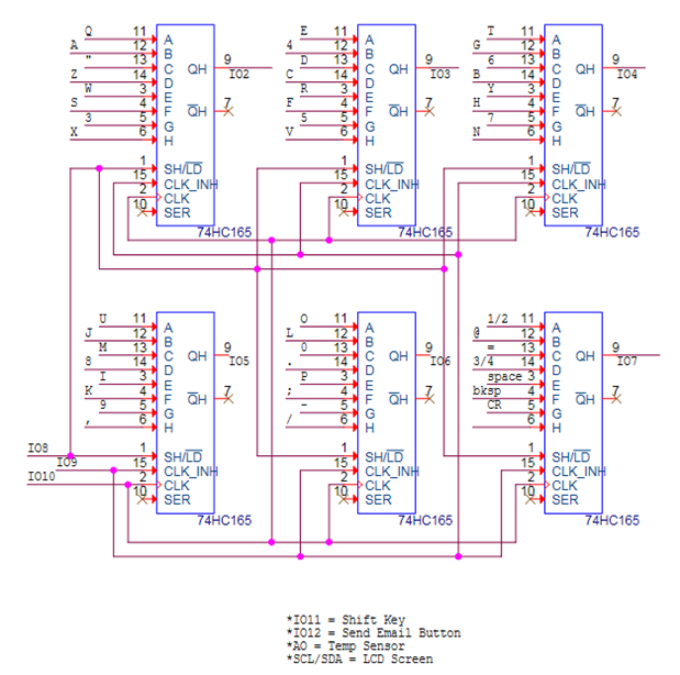

This brings me to my next step. I will use some parallel-in/serial-out shift registers to allow the 44+ inputs to be read by the Edison. As for the inputs, there are 44 arms plus the shift key, space bar, backspace, carriage return, and a "send email" button. This means I can get away with using 6 8-bit PISO shift registers. That's 3 GPIO's for control, 6 for data, plus I will dedicate one GPIO to the shift key and one to the "send email" button. That brings the grand total to 11 GPIO's, which the Arduino breakout board can manage!

Here's a schematic showing how the shift registers will connect to the typewriter and Edison:
