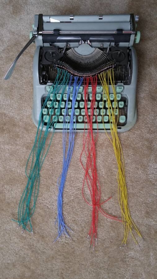

In my last post I showed how I attached loops of copper wire to the typewriter to act as part of a "normally-closed" switch (with the type-bars acting as the other part). I have now attached wires to these loops so they can be connected to the shift registers. Check out this picture, it looks like my typewriter has some funky hair!
You may notice a few things in the image above. First, the wires are different colors. There are 44 wires total so I used a different color for each group of 11 wires. Can you imagine 44+ wires of the same color running through the typewriter? It would be very difficult to trace out a specific wire when troubleshooting. Next, you may notice the wires have pins on them. I crimped pins on the ends of the wires so I could plug them into a breadboard easily. It was a tedious but necessary task. Lastly, you may not be able to see from the picture but those are silicone wires. Silicone wires are more flexible and flexibility is important when working with limited space (like inside a typewriter).image

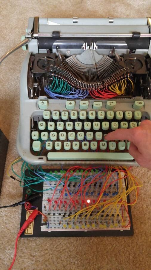

Note that I haven't tested this code yet - so if you see any glaring problems please let me know! While I'm talking about testing, I should mention another aspect of this project. You see, when I finally test this system and I don't get the results I expect, how will I know where the problem is? It could be that the code is wrong or maybe the typewriter isn't wired correctly. So I decided to design a testing board. Basically it's a bunch of LEDs - 44 to be exact - which will turn on when a key is pressed. This way I can see what the Edison would "see". You can see this testing board in use below.
The board is pretty simple. Basically, the wire that would go to the Edison now goes to the base of an NPN transistor. The transistor controls an LED. See how the LEDs are color-coordinated with wires? Pretty smart, eh? And they are in order - the 3rd blue LED corresponds to the 3rd blue wire on the typewriter. The whole thing is powered by a 12V lead-acid battery connected to a 5V linear voltage regulator. So now when I press a key, a light will turn on! This board took a while to set up but it has already revealed some very useful information. First, some of the type-bars weren't resting on the copper loops very well. I have adjusted some of them to fix the problem but some others will require more work. Second, I realized that while I'm typing, lots of the LEDs flicker! I believe that this is caused by the constant vibration that the typewriter feels while someone is typing. This vibration is enough to cause the type-bars to break the connection with the wires momentarily. The Edison will read this as me hitting many keys at once, but I believe that my code will be able to distinguish between the real key press and the vibrations causing momentary "glitches".image

    Nice update.
    I do worry about debounce and you might see some interesting EMI effects if you have a good typist.
    It would be a very interesting experiment to set up a signal analyzer with a simple antenna near the keyboard as it is in use.
    mcb1 over 9 years ago
    Excellent work.
    You testing routine has shown some issues that might have caused a headache had you not done this step.
    I think you are quite right that timing will be the difference.
    I presume that you will get bounce when the key returns as well, so you might need to factor that in.
    If the software routine gets too hard, you can always try the hardware approach and install 44 capacitors across the inputs.

    Is looking good Joey, good choice on the wires.
