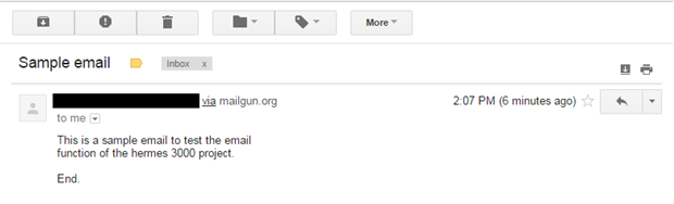

Lastly, I wrote some code that will wait for a button press, then call the send_email() function, then light an LED if I get a response code of 200 (so I know the request went through).

When I run this code and then push the button, I see the LED light up for a second and then I get this in my email:
So the email sending function works! Here's how it will all go together: the user types an email which will have the same format as the sample email above. These characters will get written to a file as the user types. Then the user will press a button, the send_email() function will be called (but it will create the email from the file the user was modifying - not the sample_email file). The email will be sent off and the file will be erased so the next email can be typed.
