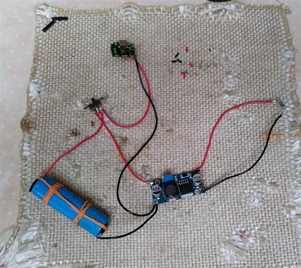

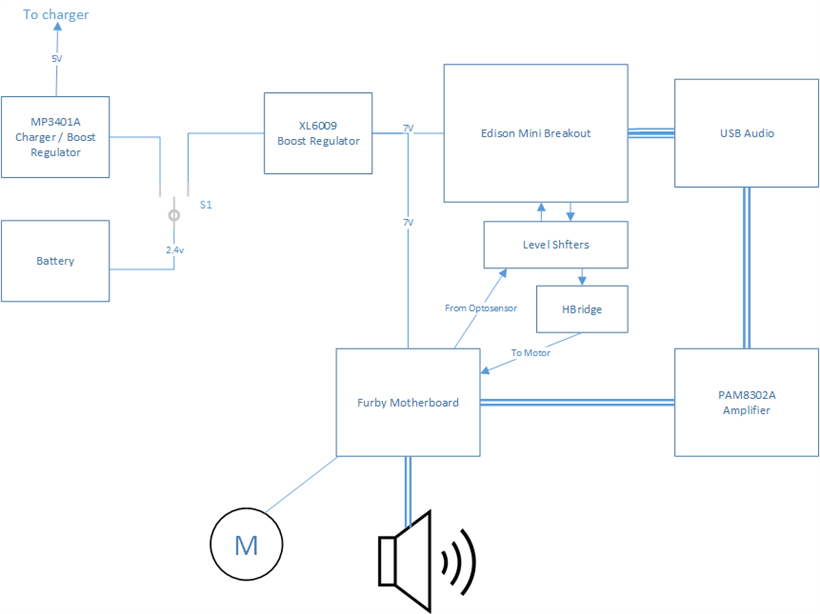

After the various modifications, repairs and tests it was time to put the Furby back together. The speaker wires were soldered in place and all the cables hot glued to act as a basic strain relief. A hole was made through the battery box to route the wires through to the Edison (via the level shifters). The power cables were extended and a couple of damaged links on the board were replaced. Once that was done the case could be re-assembled.
Power
As mentioned previously the Edison needs 7v to be able to power the board and USB correctly. To support this a boost regulator was added to the circuit based on the popular XL6009 chip. I initially planned to keep the 5v regulator from the origional battery box but that was not working when I tried it. Instead, I added a switch so that the battery can be switched between charging and powering. This can also be used as an off switch. I used the 100Ω high power resistor from the LED downlighter to load the board whilst I adjusted the output to 7v. I also checked that it stayed at 7v when the load was off.

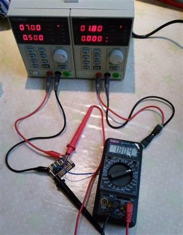

Level Shifters
I tested the level shifters with a dual power supply and a multimeter. Three worked as expected but one did not. Rather than 7v / 0v, there was around 2v on the output. So I swapped out the FRB590 with a BC549 and it tested ok.

I nearly forgot to include the H-Bridge but luckily there was a bit of space under the Edison.
Edison
Thanks to gpolder and the pinout he found, soldering up the connections to the breakout board was straight forward.
