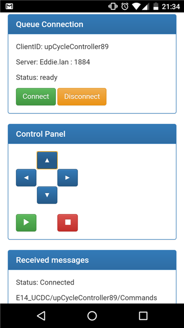

There's been a few recurrent problems with the solution mostly around the fragile wiring and power issues. The subsystems have all been tested and checked over the last couple of weeks in an attempt to get a better demo video. It's quite a complex design with multiple batteries, power convertors, grove connector breakout boards and level shifters. The results is that I've not actually had driver and car working at the same time from battery.

I've also been working through the software getting it all working together, I had trouble with DNS and security but resolved all that, last week. https://github.com/Workshopshed/UpcyclingDesignChallenge

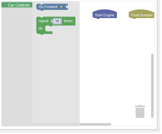

The web page for driving the car is really just there to test things. What I would really like to have is a UI that my daughter can use to learn basic programming concepts. I've been looking at various things and Blockly looks good, it's open source, multi-platform and is easily customised. Blockly basically allows you to drag blogs onto a design area and when you run the code it compiles those into a language of your choice such as JavaScript. It's possible to create custom blocks with code which would send the same messages to MQTT as I currently do with my buttons. I can customise and add to the UI as she and the car evolve.
