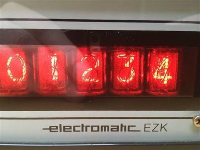

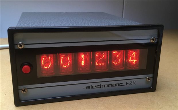

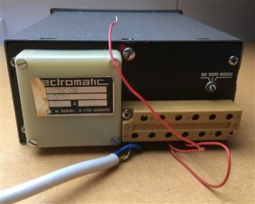

Look what I recently found on my attic. A nice box with a six digit nixie display. Even some documentation was in the box, showing that this is a 'Impulszähler EZK' from 'electromatic'. I can't remember how it found the way to my home. It might be that I bought it long ago on a flee market, or maybe I got it from a friend.

First I connected the device to the mains power and lucky me, it worked out of the box. The documentation showed me how to add some wires on the back in order to count  the pulses.

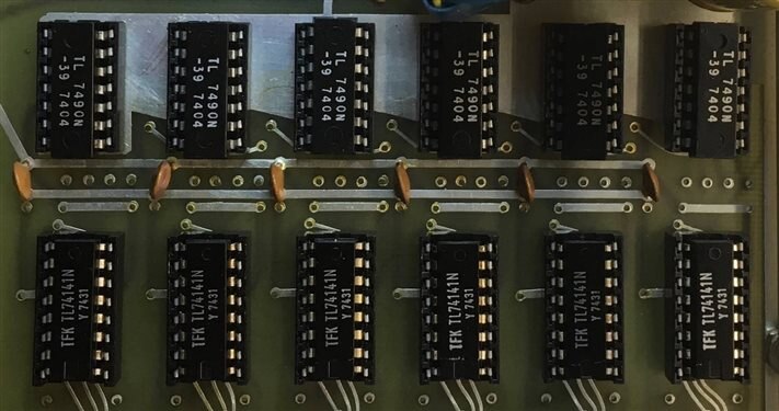

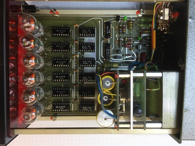

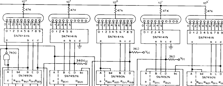

Next I opened it and again I concluded that I'm lucky since it looks like very easy to modify. The circuit is very straightforward, the very well known SN74141 nixie tube driver is used, driven by SN7490 BCD counters, as can be seen on the photo and circuit diagram below.
Another good thing is that these IC's are not soldered to the PCB, but placed in sockets instead. So I easily can remove the 7490 IC's and replace them with a connection to the  IntelRegistered Edison.
