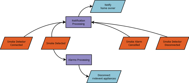

Integration Design
Once sensor detects smoke, it will publish a message to MQTT topic. Then this message will be passed to a mobile application and at the same time will be converted to a command to switch of all connected electric appliances in the room where smoke has been detected. It is important to define the topic model before coding.

  • vlasov01
    vlasov01 over 9 years ago in reply to mcb1 +1
    Thank you for the feedback! I've added a diagram to clarify events processing sequence. Sergey

    Very good write up and thought into your topic.  I really like the idea, and I have never done this, is put in if a device type, assuming it is only doing one function.   But in reality, the MQTT topic for each sensor inside a device and be specific to what it does.  Then in the future you can monitor based off this structure.  So your Node application, can listen for #/#/smoke/state and get state changes for all locations.  Then query a database to see what to do based off the structure of the topic.  Only suggestions I would make would be the following.
    1. Work in a device name or indicator to the structure. I think this would be at the start of the structure, since it is the most broad level you will have.  For example, I have a light controller in my basement, well it also monitors current flow to my 80 tower, so I know when power is out to the tower.  It controls lights for several devices around my home.  So all of it's MQTT topics start with rpi01/...  This way I know what device is doing what and do not need to refer to a document to find what device has that message and command.  Full example like you gave above based off an Edison with IP reservation ending in 138:
      "Eddy138/kitchen/alarm/smoke/connected"
    2. With this example a device might have several locations or might not.  Most likely it will have several functions, like sensor or alarm or power. Also several types and commands|state
    3. Not really MQTT topic structure important, but it will be done via MQTT. One needs to know when sensors are not responding, so I think the best way to do that is with heartbeats being sent out on a regular basis. Last thing you want is a fire that was not detected, because a sensor has stopped working two months ago. If the Edison stops working or gets powered off, it does not send out it's heartbeat and a process at central command can monitor for this heartbeat and alert you when a device is non-responsive.  Two ways to do this:
      1. Every minute send out a MQTT topic of <devicename>/heartbeat with a message of "alive"
      2. Have a process that responds to alive queries, like a master node that publishes <device>/query/status and the device then responds with <device>/alive with a message of "yes", maybe also report battery level, etc.
    Once again, great job on getting this started and let me know if we want to roll in a device name.
