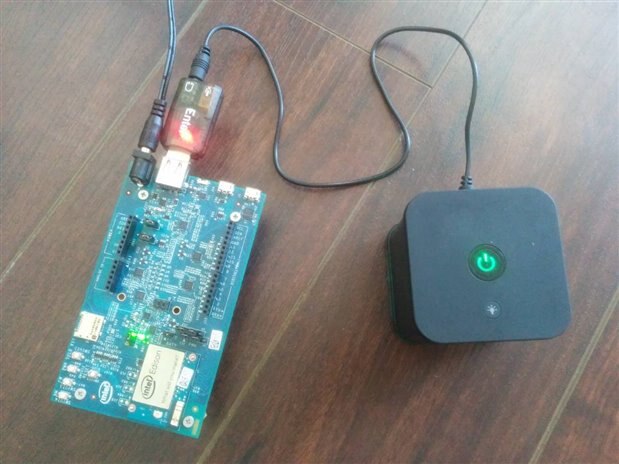

Connect the USB sound card to the Intel Edison and connect power to the Edison using the DC power jack as shown in the picture below.

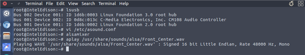

To check if you USB sound card is detected run following command
lsusb
you should now see the name of sound card, in my case in the screenshot below it is the second entry.
Create a file under the /etc directory and add the following line in the file
vi /etc/asound.conf
pcm.!default sysdefault:Device

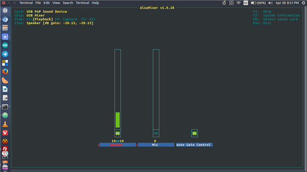

No to select your sound card and increase/decrease the volume, run the command
alsamixer
  • select the USB sound card by hitting F6 on the screen and selecting the option "USB PnP sound device"
  • Increase and decrease the speaker volume using up and down arrow keys.
Finally to check if you are able to hear sound from the speakers run the following command which will play a test file which was created as part of the alsa-utils intall
aplay /usr/share/sounds/alsa/Front_Center.wav

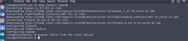

Now if you have heard sound from the speaker image , it is now time to install eSpeak by running the following commands
opkg install espeak
And also run the following to test if you can hear the text phrase on your speaker.
espeak "Hello from the Intel Edison"

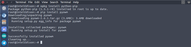

Now to get weather data from openweathermap.org you will have to create an new account at , and run the following command to install pyOWM
Install PIP using the follow command
opkg install python-pip
in my case, as you see the screenshot below , I had installed python-pip a couple of days back. Once done install pyOWM using the command
pip install pyowm
