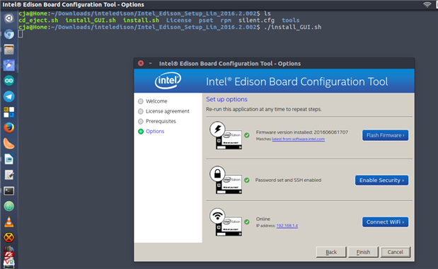

I finally received my package image  a couple of days back on Thursday, after the package made couple of trips from Chicago to Los Angeles and back again. A big thanks to rscasny for helping me out, and quickly re-sending package.

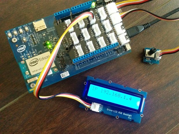

As part of today's blog post I have managed to setup connect the Intel Edison on the Arduino base board to show the IP address assigned to the Intel Edison by my WiFi router and also show the temperature from the Grove temperature on the RGB LCD screen which came as part of the Grove Arduino sensor kit.

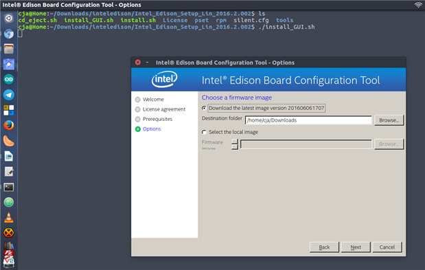

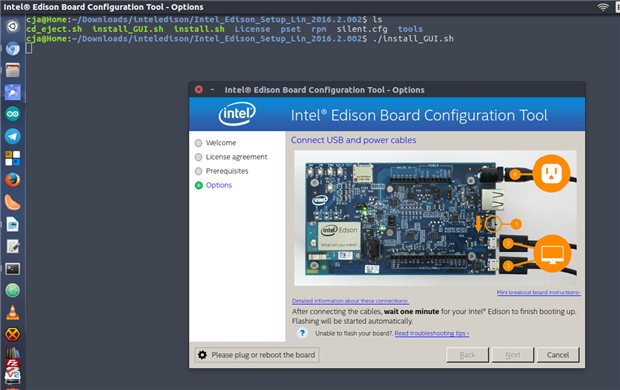

I started by downloading and  flashing latest Yacto image on the Intel Edison use the guide on intels website , which you can find at - https://software.intel.com/en-us/assembling-intel-edison-board-with-arduino-expansion-board. For flashing firmware I used Ubuntu 16.04 and you can find the documentation with the steps at - https://software.intel.com/en-us/flashing-firmware-on-your-intel-edison-board-linux  . Here are some screenshots of the flashing process
{gallery} Flashing latest version of Yacto
Iimage

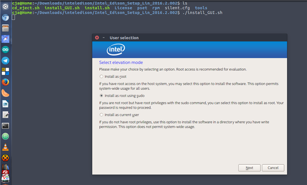

Run the install_GUI.sh

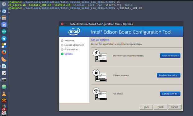

Accept the Licence Agreement  and then hit the Flash Firmware button
Browse the folder you would like to download the latest firmware

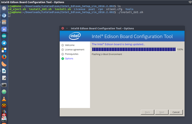

Plug in you Edsion board, here are I used 2 USB and plugged it to my laptop. Don't forget to toggle the switch as shown in the picture above

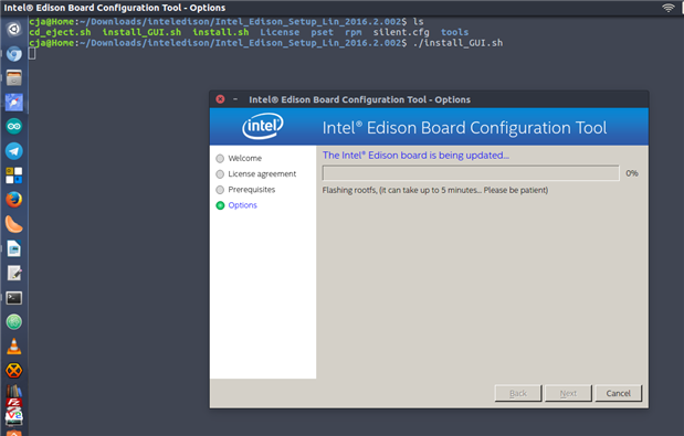

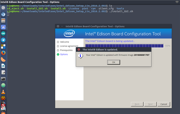

Once you plugged in you USB cable to the computer the Edison will begin to flash
this can take about 5 to 6 mins

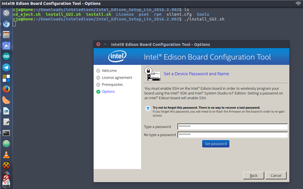

Setup your root password by hitting the Enable security button , which you will use to ssh into the Edison
Also connect to your Wifi router

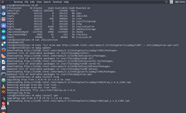

From the terminal on you computer ssh into the Edison using
ssh root@ipaddress
And then run the following commands on the edison to get the latest version of MRAA library and UPM
echo "src mraa-upm http://iotdk.intel.com/repos/3.5/intelgalactic" > /etc/opkg/mraa-upm.conf
opkg update
opkg install mraa
opkg install upm

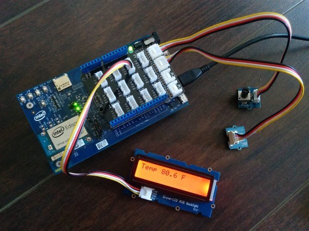

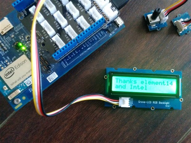

Now, connect grove shield to the Arduino breakout board and then connect the following grove sensors using the connectors
  • RGB LCD to one of the I2C
  • Pot to the A0
  • and Temperature sensor to A1
Using you favorite FTP tool, upload the python code to below to the Edison and run the python program
python checkIPaddressTempLCD.py
Now use the Pot to the check the temperature and IP address. And a big thanks to Element14 and the sponsors Intel.
{gallery} Using pot to test
IP address of the Intel Edision
Showing Temperature
