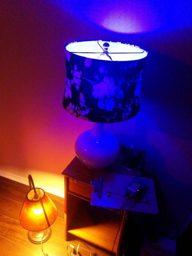

  • Turn on the lights in your house when it gets dark, in my case the idea is to turn on the Phillips Hue Lights.

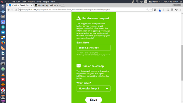

  • And, in addition I have also setup another recipe to cycle through various colors of the Hue bulb, which I am calling party mode image

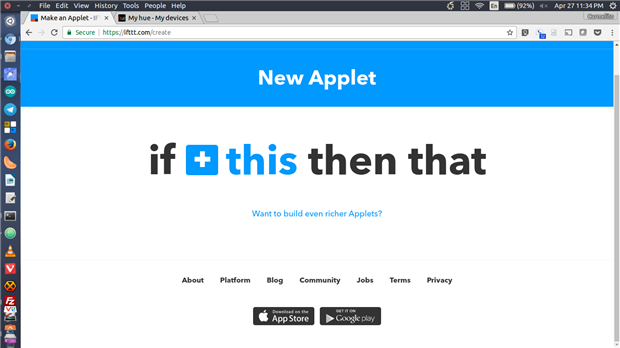

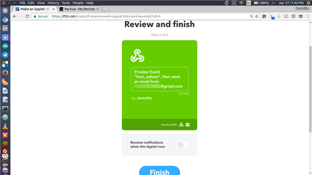

To create a new recipe to send sensor values from the the Edison via an email when the python program below is triggered, click the new applet button and follow the steps as shown in the screenshots below
{gallery} IFTTT recipe to send email

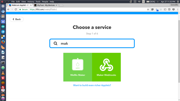

Once you click the New Applet button , click the + this link

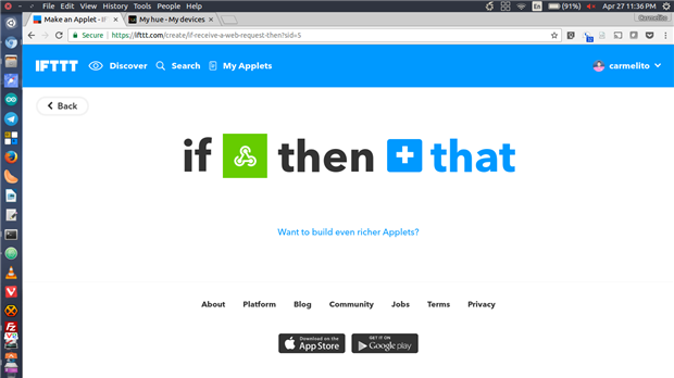

As part of the service on the IF side select the Maker Webhooks channel

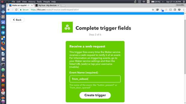

Type in the event name - from_edision and hit Create trigger, this will be refrenced in the python code
Now select the +that section

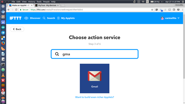

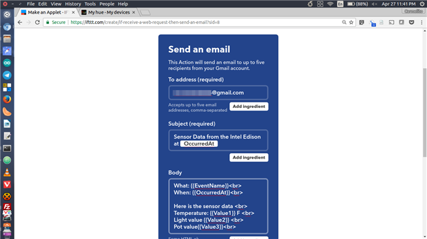

As part of the That action seach for Gmail

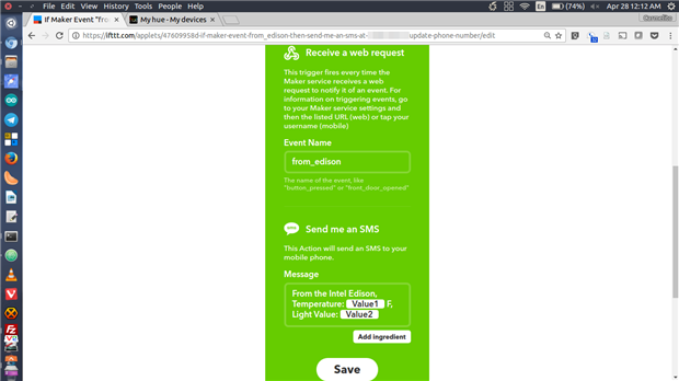

Fill in the details for email, here the Value1, Value2 and Value3 are part of the payload section in the python code.
Once done hit the review and finish button.

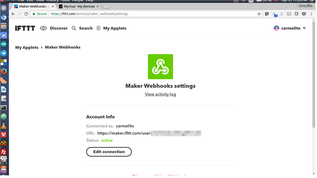

As part of the code replace the api_key with your key, which you will find at  https://ifttt.com/services/maker_webhooks/settings

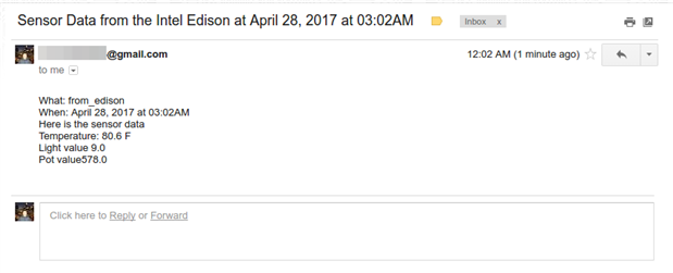

Here is the sample email recived once the program run

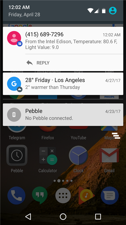

Recipe setup to send text messages
Sample Text message recived with temperature and light reading from Edsion

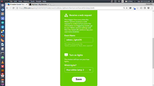

Recipe to turn on your Hue lamp, for this you will have to select Hue on the Then side of the recipe
Recipe for the Hue Color bulb to change the color of the bulb slowly, setting up party mode, for this you will need a Hue Color bulb.
Lamp on top of the side table has the Color Hue bulb which cycles through the colors. And the lamp on the floor has the white bulb.
