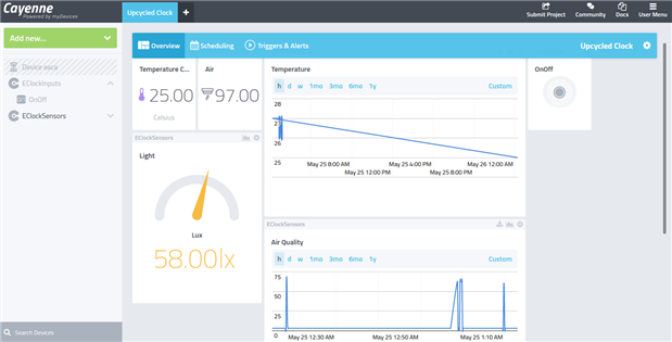

When I attended Makerfaire Bay Area last week , I heard a talk by the folks at myDevices, who build an IoT platform called– Cayenne,  which has an online IoT dashboard that takes most of the complication out of creating hardware-oriented programming, originally it worked with just the Raspberry Pi, and is now available for the Arduino as well. In addition, you also have a feature were you can use MQTT to post sensor data to Cayenne IoT dashboard, this means we can use the Intel Edison to post sensor data as shown in the picture below. For more info about Cayenne check out the documentation at https://mydevices.com/cayenne/docs/

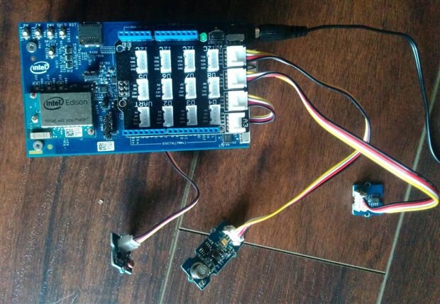

As part of the Circuit I have the Intel Edison connected to Temperature, Light and Air Quality sensor data to Cayenne
  • Grove Air Quality sensor (version 1.3) connected to A0 on the grove connector shield
  • Temperature sensor connected to A1
  • Light sensor connected to A2

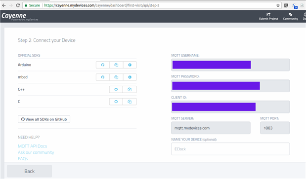

To setup your cayenne dashboard create an account at - https://mydevices.com/ , and then add your own device using "Bring Your Own Thing API selection" icon, and make a note of the following
  • MQTT Username
  • MQTT Password
  • Client ID

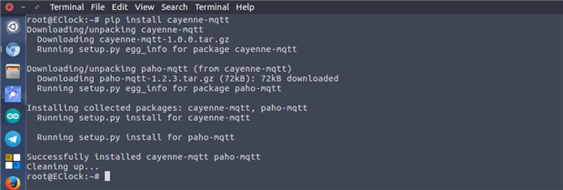

Before we run the python program below, we will have to install the cayenne-mqtt package using pip
pip install cayenne-mqtt
Here is the python code use to upload sensor data to cayenne. And once you run the python program below, after updating the MQTT_USERNAME, MQTT_PASSWORD and MQTT_CLIENT_ID you should see your new sensor appear in the dashboard. You can then create a new project in Cayenne and added the sensor to the project. (* as part of the dashboard picture above you can see there is an on/off button, which i plan to trigger/control a couple of things on the Intel Edison, which is going to be part of a future blog post)
