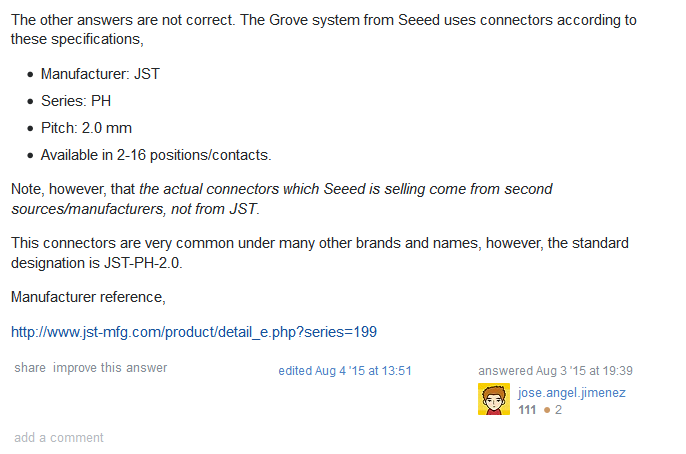

I was wondering about using the Grove shield and cabling but adding my own items at the other end.  Obviously, I can cut off the connectors and add my own but it might be nice to use sockets instead.
Does anyone know what part numbers I'd need for a grove compatible header on my stripboard or PCB?

    Those are the cables, I was thinking about the sockets for my own boards so I can use the provided cables.
    Does this look like the right one? B4B-PH-K-S(LF)(SN) JST (JAPAN SOLDERLESS TERMINALS), Wire-To-Board Connector, Top Entry, 2 mm, 4 Contacts, Header, PH Se…
    There appears to be a latch on the above pic but not on the linked item.

    From twitter:
    @pinski1_  "these are latching headers so PA rather than the compatible but non-latching PH."

    So perhaps these ones?
    B04B-PASK JST (JAPAN SOLDERLESS TERMINALS), Wire-To-Board Connector, Top Entry, 2 mm, 4 Contacts, Header, PA Series, Thr…

    The most probable connector is the NSTech 1125 Series.
    The connectors are available from Seedstudios and hopefully with this information element14 will as well.
