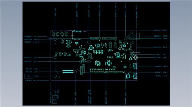

I was going to enthuse over the great mounting points on the Arduino breakout board. They have space around them for screw heads and the standoffs don't clash with components. However I've just spotted that they are not in a nice rectangular matrix with one pair being slightly offset from the others.
So that's a long way of asking.
Does anyone have a drawing showing the correct positions for each of the mounting holes on the Arduino breakout?
    mcb1 over 9 years ago +2 verified

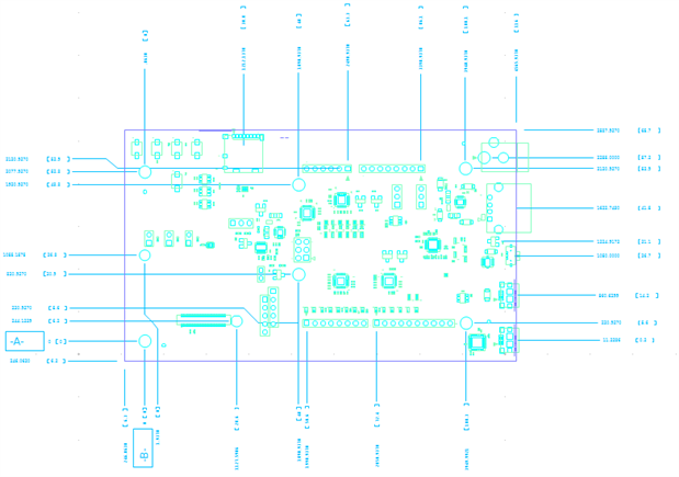

    Mechanical dimensions are here. https://downloadcenter.intel.com/download/24798

    Hi volly looks like the Edison breakout mounting points don't align with those of the Arduino Mega. The 4 on the right do align with the "standard" Arduino layout though. The dimensions from Mark do have…
  • Workshopshed
    Workshopshed over 9 years ago in reply to mcb1 +1
    Yes, the information is there and the reference zero is the bottom left hole.

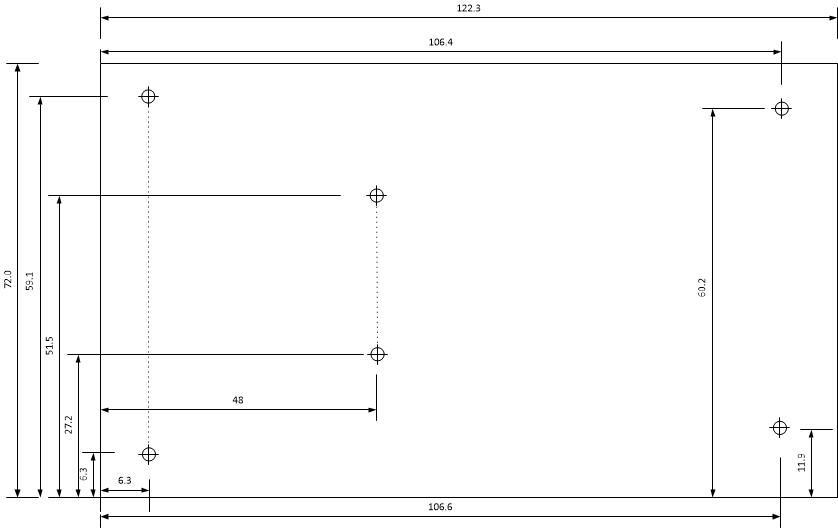

    Hi volly looks like the Edison breakout mounting points don't align with those of the Arduino Mega. The 4 on the right do align with the "standard" Arduino layout though. The dimensions from Mark do have the right values but in a bit of an unusual format. I'll see if I can turn that into a useful picture.
    I believe I've transposed it correctly and re-baselined it to the bottom corner.  I understand why it makes sense to use the hole as a reference point but if you want to make a case then something a bit easier to read is handy. Best to point out that the pic below is a sketch not a cad drawing so take the written dimensions of the pic don't measure from it.

    0 mcb1 over 9 years ago in reply to Workshopshed
    I thought that at first as well.
    It seems that they used the lower left mount hole as the reference point 0,0 and the figures in brackets are millimeters.
    This may be a better picture.image
