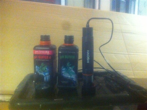

This Blog will cover how to measure pH in your aquaponics/hydroponics system, later we will be using this reading to control the pH.
Take a look at the blog below to see why PH is an important factor and why we need to be controlling it.
Blog:20.2 - Toying with Chemical Analysis - pH

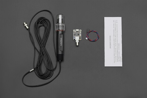

The pH Probe
DFRobot have been nice enough to send me one of their MCU pH sensors, it is the pro model with a longer life than the normal probes [hopefully I cant break this probe].
What else you will need:
>pH calibration fluid [4 and 7]
>Arduino mega/uno

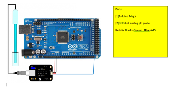

Wiring diagram
Calibration
pH probes need to calibrated routinely [one a month is a good idea] so we better have a code that lets us easily calibrate the thing.

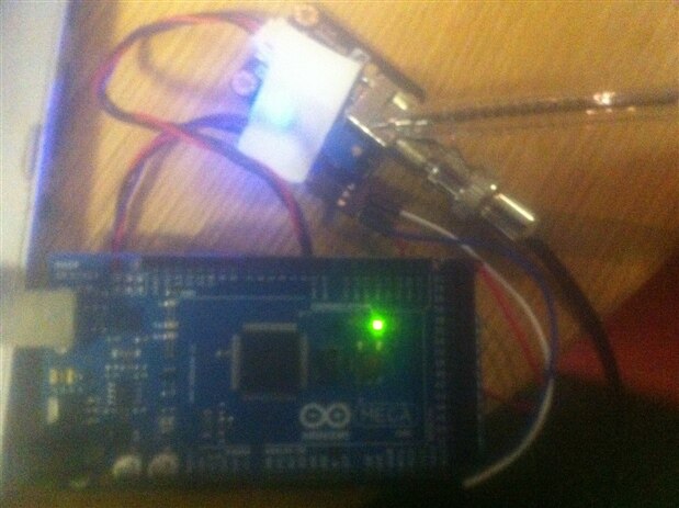

Wire the probe up like the diagram above, upload the code below and then:

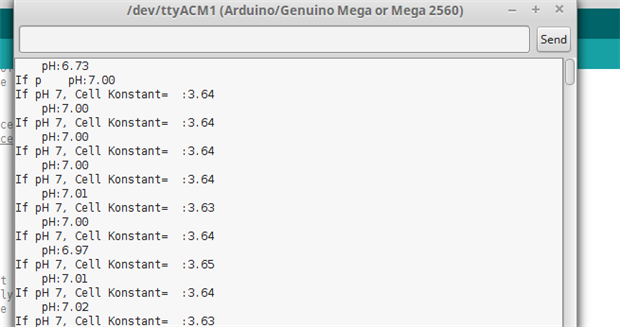

1:Place Probe into pH7 calibration fluid, open serial
2:Take Recommended cell constant and change it in the top of code
3:Rinse Probe and place in pH4 calibration fluid
4:Adjust potentiometer on pH meter shield until ph reading in serial is 4
That's it, you are now calibrated and ready to use the pH reading from serial.
The Code
This reads the ph probes shield [its an analog value] averages ten readings to reduce any noise and converts the ADC reading into a ph value. outputting the reading to serial.

  • m.ratcliffe
    m.ratcliffe over 10 years ago in reply to DAB
    I got good readings over a hour, its a bit awkward to have the data over serial when working on the laptop. The next blog will be with a LCD and logs min/max PH, so I will leave it in some water overnight for a little longer of a test.
    It certainly feels a lot sturdier than the ones ive used in the past and the spec sheet says it is for "long term use" but I dont have enough data to confirm this at the moment. I hope it does live upto its claims, pH is what ive always struggled with the most.
