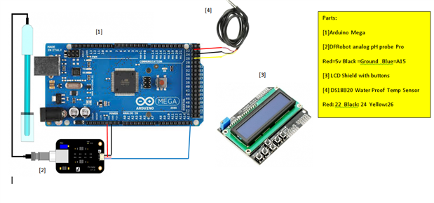

DFRobot were nice enough to send me one of their pH pro MCU probes [Longer lasting] but this tutorial and code will work for any analog pH MCU meter [ebay special etc] these are coming down in price rapidly but I recommend calibrating often. I'm hoping the pro model can go longer between calibrations and still hold true. I put the probe in some pH4 buffer solution over night and the LCD printout gave a   min:3.92   max:4.02   this was probably caused by a temperature change. But it is good enough for our application without compensating for temperature.
This is the style of PH  probe we will be building the PH controller in the next blog, it has been built and in action now. Once it has passed [or is it if] its month of problem free use the code will be uploaded here, under gnu as always.
Pin-out
The Code
We have writen the code mainly by calling functions [blocks of code] from the main loop. It can be helpful to write codes in this way because many projects will require similar blocks of code [uptime, max ram , temperature etc] and we can quickly make a new script using these blocks of code.

    Parts:
    -Arduino - Uno/Mega
  -df Robot Ph Probe Kit [SKU:SEN0169] This is a great PH sensor compared to the ones ive had in the past
    See www.MichaelRatcliffe.com/Projects for a Pinout and user guide or consult the Zip you got this code from
