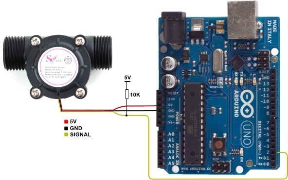

A updated Flow meter monitor to incorporate a LCD shield, log min and max flow rates.
If you want to incorporate some error logging [water loss or burst pipe] see the last blog for setting error flags.
LCD Shiled that it will work with:
Pinout [Solder onto LCD shiled is preferred ] :
Ignore external pull up, we are doing that in software instead
Header 1

    Components:
    See main folder for sensor data sheets, required liabaries and extra information: [can be downloaded via www.michaelratcliffe.com]
    All power systems should be powerd of DC voltage of below 48v for safter [water is around] 12v is prefferable and cheapest. As always this is a DIY project and done at your own risk.
    >Arduino Uno
    >Hall Effect Water Flow Meter 5v
    >LCD button Shield [Hobby tronix]

#define Water_pin 2
/*/####### Meter Specs ####//
Most meters are shipped with a forumla to work out flow rate
F=X*Q
Q=Flow rate in L/min [make sure its in L/min and not L/hr]
F=Frequency
X= variable
To work out click per L  Clicks = 60*X
float Click_Per_L = 450; // this depends on your flow meter

Serial.begin(9600); // starting Serial Com's
//Stoping noise from being a problem, pin is high untill hall sensor pulls it low
pinMode(Water_pin, INPUT);
digitalWrite(Water_pin, HIGH);// saves having an external pullup
//External Interrupts: This is what the watr meter pulse count is collected from
attachInterrupt(0, WaterCounter, FALLING);  //watermeter pulse output connected to pin3

    Im using an ancient Flow meter that I found in the barn, that I had to replace the hall sensor in.
    But this should work with the one you linked to, or any 5v based hall effect meter for that matter. Got a project in mind?
