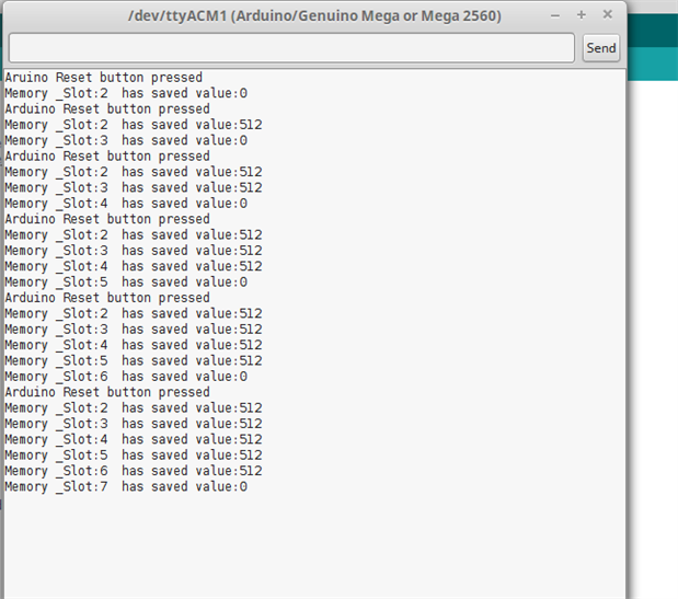

Sometimes we want to store data on the arduino that will survive a reset, calibration settings and set points are an example of this. EEPROM is a non volatile memory on the arduino that we can write values to and read in the setup loop to keep the values after a reset.
There are many blogs that will talk about, writing and reading EEPROM, but not many [if any] talk about checking if the memory slot has ever been written to in the past. We want to be able to use the value of a variable [ie setpoint] from the eeprom if there is one there, if there is not we want to use a defined value from the sketch.
What this code does, it reads the eeprom to see if there is a value to read, if not it ignores the eeprom and substitutes the one from the top of the code.
here is a serial screenshot showing it in action, resetting makes it move onto the next memory slot:
Header 1
Script to test how to check if eprom is written or not
it will start at memory slot 1 and print value if it has ever been written
it will then write the next empty slot to the value you put at the top of the code

    It comes in handy when you are putting a new system in but wont have time to calibrate it for a while, you can specify a good estimate that will keep it up and running  until calibration. It is only 8 bit memory slots, but the ide has a few other eprom functions to store/read longs etc. Hopefully I will find a way to do the same check with some longs.
