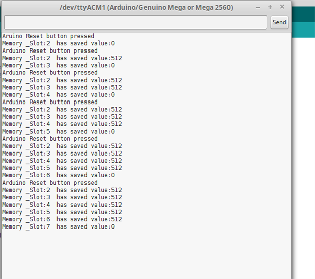

Sometimes we want to store data on the arduino that will survive a reset, calibration settings and set points are an example of this. EEPROM is a non volatile memory on the arduino that we can write values to and read in the setup loop to keep the values after a reset.
There are many blogs that will talk about, writing and reading EEPROM, but not many [if any] talk about checking if the memory slot has ever been written to in the past. We want to be able to use the value of a variable [ie setpoint] from the eeprom if there is one there, if there is not we want to use a defined value from the sketch.
What this code does, it reads the eeprom to see if there is a value to read, if not it ignores the eeprom and substitutes the one from the top of the code.
here is a serial screenshot showing it in action, resetting makes it move onto the next memory slot:

This will come in handy in our later projects.
    DAB over 10 years ago
    Nice, I will take a look to see if this is something I can use.
    Thanks
  • m.ratcliffe
    m.ratcliffe over 10 years ago in reply to DAB
    It comes in handy when you are putting a new system in but wont have time to calibrate it for a while, you can specify a good estimate that will keep it up and running  until calibration. It is only 8 bit memory slots, but the ide has a few other eprom functions to store/read longs etc. Hopefully I will find a way to do the same check with some longs.
