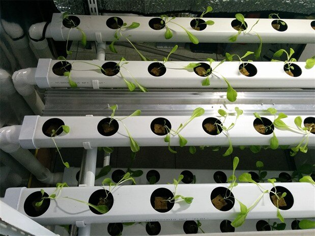

Our hydroponic system has two allotments of 40 plants each (top/bottom). We started growing on the top floor with an equal ratio of DeepBlue (DB-450nm), HyperRed (HR-650nm) and FarRed (FR-730nm) with a total power of 20 W while we used double of the LEDs on the bottom floor. The results on the growing were so clear after one week that we had to double the LED power installed. Before adding extra light, the plants were very fragile and elongated as shown on the next picture:

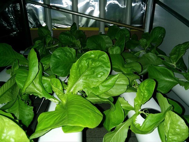

Also left and right sides got different behaviors due to the reflectivity of the cover material:

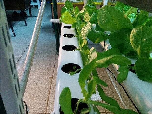

The plants from the left side bended towards light direction positioned at a central position. This will lead to another improvement on our next trial spreading evenly on the growing area or shaping the beam light with secondary optics. The effect can be clearly seen on the next image.

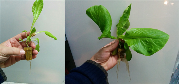

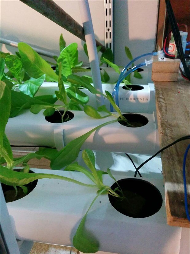

Due to the shadow of the metal frame structure used to reinforce the structure and some pipes, four plants on the extremity become elongated and fragile as clearly seen on the next image:
The effect is also visible on the weak radicular system compared to center ones:
