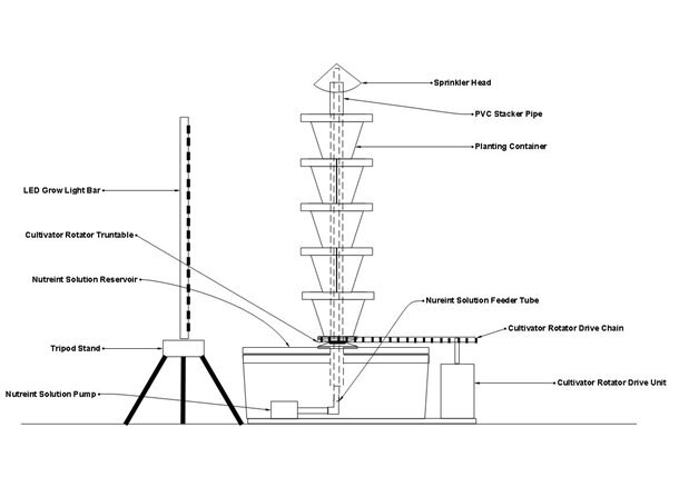

Section 1 : Recap - Ok, in my last blog post I talked about my design for rotating the stackable container cultivation unit. See images below. I had originaly designed a belt driven unit, image on the left, but then opeted for a direct contact design, image on the right, instead. All in all, I've ended up with an implementation that is very close to the chosen design. Again, the purpose of the rotator system is to assist in providing uniform lighting, via a vertically oriented LED grow light bar, to the cultivator unit while maintaing a minimal footprint.
The chosen design for the rotator system uses a stepper motor with a timing pulley driving a "timing disk" based turntable. I chose the direct contact design because it reduced the over all footprint of the entire cultivation unit. The entire cultivation unit footprint, not including lighting, is now 16" x 16". The unit will support between 18 and 36 individual plants, depending on plant type. The actual rotator system can be seen in the image below. I like to call this a prime example of rig-gineering. In the image you can see the stacked container cultivator unit resting on top of the fabricated timing disk/turntable along with the stepper motor/timing pulley drive unit. The motor mount system was fabricated from scrap brackets. It employees rubber spacers to allow for tension adjustement of the direct contact drive system. Nothing fancy but it works pretty well. For a detailed parts list and design description please see my Stacked Container Hydroponics for Vertical Farming : Blog 3 post.
The actual application of the rotator system will be somewhat different than described in my last blog post. I had imagined a contiuous and very slow rotation of the cultivator. In suing the completed rotator however I believe I will instead use a priodic rotation scheme. Rotating one set of plants into position and allowing them to remain for an 8 hour period and then rotating to the next set of plants. As there are basically 6 plant positions around the circumference of the cultivator unit the I will rotate he cultivator so that the lightitng bar is positioned between two planting positions. I am also considerning a periodic oscillation within the 8 hour period to assure that the entire plant sruface, in both planting positions, receives adequate light.
I have also completed the control software for the rotator system. It currently includes control functionality for speed, idle time, direction and stop. The software was written on the EFM2ZG using SimplicityStudio. I am hoping for, and believe it will be, an easy port to the EZR32WG device when I receive starter kit. The plan is to control and monitor the cultivator unit from one of the EZR32WG. I will establish a radio link to the second EZR32WG which will be linked serialy to a Raspberry Pi. I currently have this serial link between the EFM32ZG and the Raspberry Pi. The second EZR32WG will provide the Pi with a method of wirelessly controlling and monitoring the cultivator unit. This setup could be scaled up to some number of cultivator units. I have created a video that demonstrates the EFM32ZG/RPi link and the function of the rotator system. See the video below.

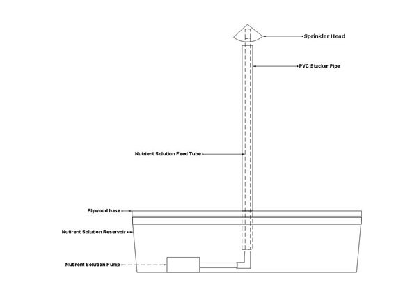

Section 2 : New Business - So, now that the rotator system is done, definitely the most difficult piece of the design for me, it's time to move on to the nutrient feed, the lighting and the automation and sensor monitoring systems.
  • Nutrient Feed - I am using a commercially available three part nutrient solution from General Hydroponics. I have used the GenHydro products in a couple of hydroponics projects in the past and am very pleased with the results they achieved. And, since I have some already on hand it's another element I don't have to purchase. I am attempting to keep the cost of the entire project to a minimum.
        The nutrient feed system has changed from the original design only in that I don't believe the separate PVC Stacker Pipe and Nutrient Feed Tube are required. The                          containers I'm using stack nicely and are reasonably stable without additional support. I have all parts in hand now, except the sprinkler head, and will be testing the                  design over the next couple of days.
        The nutrient feed system consists of:
    • A nutrient solution reservoir. I am using a medium sized Tupperware storage container for my reservoir. Another piece I already had.
    • A small fountain type submersible pump. Again, a piece I already had available.
    • A length of 3/8" PVC pipe.
    • A sprinkler head. I am designing this piece and will have it 3D printed.
              Please see the drawing below for my nutrient feed system basic design.image

    So far so good on the turntable. I've tested with the full stack of containers and up to about 10 additional kilos of weight.
    The stability is still my only concern. I think ti will be fine because of the way the containers lock together and as a reult of the weight in each container. But! I'm not completley certain of that yet. If i do need to stabalize it more i can use a length of PVC pipe down through the center of the stack.
