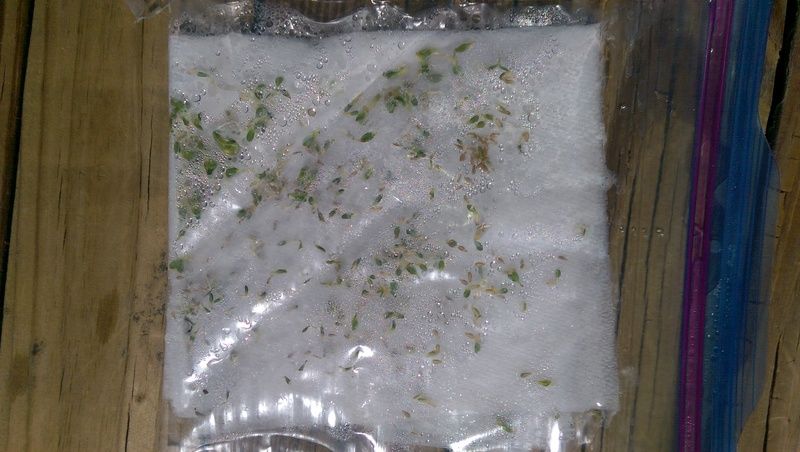

Our seeds are ready to be transferred over to a seedling tray, so I will be doing that tomorrow. This is my first time growing a plant from seed so much help would be appreciated. Here they are in my sandwich bags:
First Picture of the Seeds
