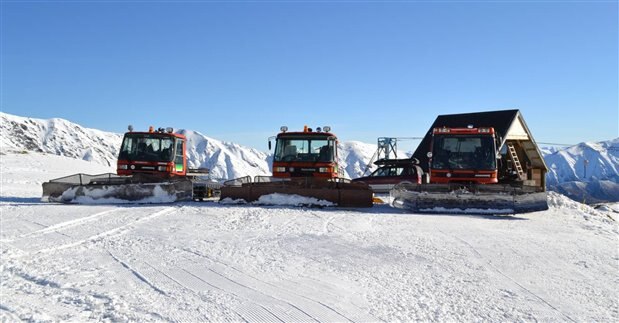

    mcb1 over 12 years ago
    Nice
    I get to play with the real ones at Mt Lyford.
    Using a 5v to 12v booster shouldn't be an issue.

    @mcb1: now I'm envious image
