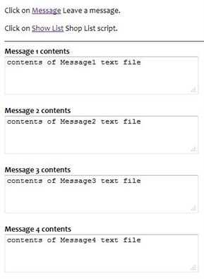

Index page, which because it runs a php script has to be called index.php

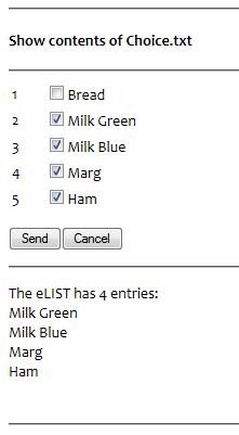

We tend to have a set list of common items, and I decided the list would be limited to 50 items.
Rather than selecting items and adding them to the list, I decided to simply tick or un-tick items on the list but allow extra items to be added.
The 'Show list' page and the result after you press Send
One of the quirks that caught me for a while was entries with a space.
While it displayed correctly, the result in $_POST truncated it to just the first word.
After untold hours searching I finally found it required the extra single quote around $partAa[0] to make it work.
(I refused to bow down to the other suggestions of avoiding the space and using underscore!)
<input type="checkbox" name="List[]" value= "' . $partAa[0] . '" checked ="1" >
I did note that the checkboxes are very small on the KOBO, but luckily in my other searching I found a way to allow the whole text to act as the tickbox. ( HTML label tag )
The idea is to add 'id= xyz' and produce a 'label' that matches the id. This means the whole word acts like the checkbox.
print '<td>' . $ListCount . '</td> <td> <input type="checkbox" name="List[]" value= "' . $partAa[0] . '" id = "' . $partAa[0] . '" checked ="1" ><label for= "' . $partAa[0] . '"> ' . $partAa[0] .'</label></td>';
Sorting
When I was looking the the Shopping Apps, there were several sorting methods, but the layout in the shop has its own order, hence most sorting methods are wasted.
Using a csv text file, it’s very easy to setup and change it around to suit, and if you wanted to get clever you could allow different sort methods or lists.
Bread,0
Milk Green,1
Milk Blue,0
Marg,1
Ham,0
The script just reads each line in the list and if ticked is added, so whatever order the original file, is the order of the list.

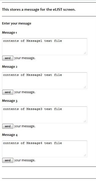

My idea also allowed for the eLIST device to display messages, and I’ve been working on incorporating this at the same time, using the same principles.
Message entry screen
I’m currently trying to decide on how to handle messages that are no longer relevant.
  • If a message suggests ‘Home at 1800’, when is it no longer relevant?
  • If it has no ETA how can the system know its run out?
The second decision was how many messages. Do you set a number and once exceeded refuse to add more?
In the meantime I've simply allowed for 4 messages as seen in the Index Page (above) and users can add extra text to the message.
I may end up cycling the messages, and like the list, the message is text based to suit a wide range of hardware.
