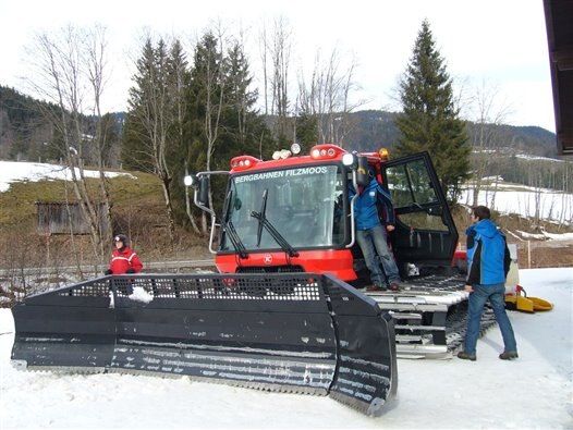

    I surely will post some pictures when the project is finished. But I think it will still loose any comparision with the real ones:

    That groomer is far too flash and looks fairly late model.
    The ones with a winch are really impressive.

    The groomer looks so shiny because it did not got so much use last season (there was just not enough snow in our regular skiing area). And I think it has a winch, but its mounted on the back, so its not visible in this picture.
