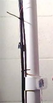

The photo interrupter as part of a high water level float switch just made sense.
Microchip MCP9701-E/TOMCP9701-E/TO Temperature Sensor IC
By living in a house with a sump pump, I've learned a few of the quirks of the system - like when the outlet freezes, the water doesn't go anywhere - so the pump just keeps on running.  In this scenario, the sump water acts as a heat sink for the long running pump.  This, of course, warms the water - quite a bit, from the two incidents that I can remember.  It wasn't until I did some experimenting for this build that I discovered how slow the water temperature rises - which is a good thing for the longevity of my sump pump.  0-1023 analog in.  It moves about 25 in 30 minutes, worst case (zero flow, almost no water added to the sump during the 30 minutes).  To get to the bath water temperature that I remember, my pump must have been running for hours.
Moving ahead, I just needed to place the temperature IC in the water near the pump and read the output.  I attached leads to the IC, put on some heat shrink to prevent shorting, stuffed it into a plastic tube and sealed the end with hot glue.

Overall Project
Again, the vision was to use all of the above components in a sump pump monitoring system.  I chose to use a more graphic build plan.  You can see some of the notes and corrections (like adding the resistors on the photo interrupter circuit).
The "as built" isn't quite as neat.  Vcc is the upper string of WAGO connectors.  Ground is the WAGO in the white mount and a 3-pack just to the right of the Vcc buss.
The third picture is the completed project.  I'm still waiting for that inspirational moment around the "packaging".  The case is functional, but I want something cooler.
