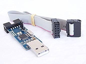

    Programmer - Pretty much any programmer for AVR that has the 6pin connector
    That is pretty much it for the moment, Probably want to get two of the Atmel units. I have a plan to use one as a signal generator for cam and crank signals.

    The AVRDude program looks for an AVR Release so go to Project->Build Configurations->Set Active and choose 2 Release. Then rebuild your project. All set...
    Plug the USB for the programmer into the workstation USB port, Plug the 6way programmer onto the Nano programmer pins, and plug the Nano USB into a power source, or the USB of the workstation. Then click on the AVR button on the icon bar and the process starts.  It takes a moment but will return with a status of the operation.
    Second, It is always good to have a communication channel to the outside world. The Nano conveniently has a USB serial port built in, and the programming of the Tx/Rx lines is actually quite simple (especially since I have done it on dozens of other systems). The workstation will need software also. I use PuTTY, because it is easy to get, easy to install, portable to other systems, and is free. PuTTY defaults to SSH, so it needs to be configured as a Serial, so click on the Serial radio button. Set the Serial line to the communication port that talks to the Nano (example: /dev/ttyUSB0). This can be found when you plug the Nano into the USB port, then read the device information (on Linux, just run dmesg and it will probably be at the bottom of the list). Then set the Speed to the baud rate in use (the source I am presenting is 19200). Last, Enter a name in the Saved Sessions box and click Save to preserve the settings. When you come back, just click on the entry in the Saved Sessions table.
