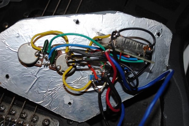

    its actually not that hard to do without any mcu Here is the DEIMOS CIV a guitar i have built myself about 6-8 years ago: 3 Pickups (2x Humbuckers) every combination possible is selectable, cut of switch…
    3 Pickups (2x Humbuckers) every combination possible is selectable, cut of switch / out of phase/ single coil selectable for every combination.
    its complex wiring but mangable , here is my build:
    notice REAL COW HORNS!!
    The skulls are knobs for Volume and Tone for the selected pickup combination
    it was a pretty tough fit inside the existing caverns of the guitar
    my concernes with the arduino-version:
    a mcu circuit could give you issues with interference, noise etc. there is also nearly no room for additional circuitry without cut opening the solid body-->may ruin the sound and give vibrating issues to the body itself.
    its overkill to run all the wires out to stomp-boxes and then to the amp(but possible) but this will / may create signal drop and even more noise. with active preamp and then messing around with the signal via arduino etc.. would be no different pickup selection but just a homemade effect box.
    greetings!

    QuantumAberrant over 11 years ago in reply to mayermakes
    That's a cool guitar but I think you vastly underestimate the space those wires takes up. As an example here is a circuit board used in modern Gibson guitars for volume and tone control.
    http://s1150.photobucket.com/user/vonserke/media/pcb_top.jpg.html
    It looks to me like there is room enough for at least an ATtiny85, and that's the hole through version. I bet with surface mount you could cram an entire ATMEGA32U4 or AT90USB1286 in there. The MCUs would not be processing the signal, just routing it from place to place probably using transistors or FETs or relays or something. Honestly, switches can be very noisy, which is why players tend not to play with them in the middle of a song. I think a transistor can be at least as quiet as a regular switch. It's possible that my dreams of a PWM controlled kill switch might be too much but believe the rest is possible and valuable.

    mayermakes over 11 years ago in reply to QuantumAberrant
    this might work , but i think the signal will be corrupted by transistors and so on..there are concerns of musicians about using different WIRE than the original because of different resistance altering sound quality.
    there are people measuring the EXACT capacitance of replacement capacitators to match the original and then shout out to the world how they have been ripped off by soemone who sold them a 47nF Cap but it doesn´t sound like "the 47nF" before.
    I´have peronaly experimented with different parts in my guitars, now I think the best signal is the one with the less influence.
