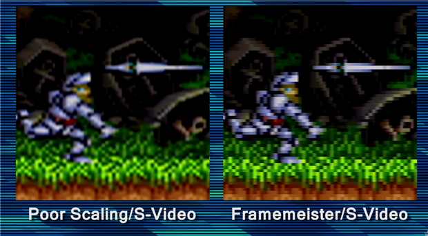

    watching from close-up since you won't see as much blockiness. I don't know what games players prefer though (I'm not knowledgeable in this). But notice when they show some examples, in some circumstances the
    video from that product actually looks worse. Here is an example where the left side is claimed to look bad. But on my PC monitor (i.e. I am up close to the screen), the right
    side looks worse because the arm looks so blocky because it is stretched at 45 degrees. I would prefer the left side image in this instance. But it is subjective, so others would disagree with this.
