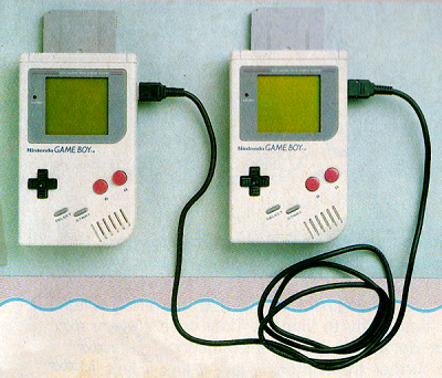

    Yet, if we must have some connectivity, why not just a USB-C connector?
    We survived 15 years of Gameboys with link cables.
    Gotta Catch Em All
    With USB-C you could include a head-to-head mode.
    And, if you must, it can connect it to your Phone for L e a d e r - b o a r d s . . .
    Finally, with the inclusion of a USB connection, you can still connect it to your PC.
    This will allow you to use it as a game controller or a number/code input device.
    (Look Ma! I can input mass amounts of vector coordinates with a ten key!)
