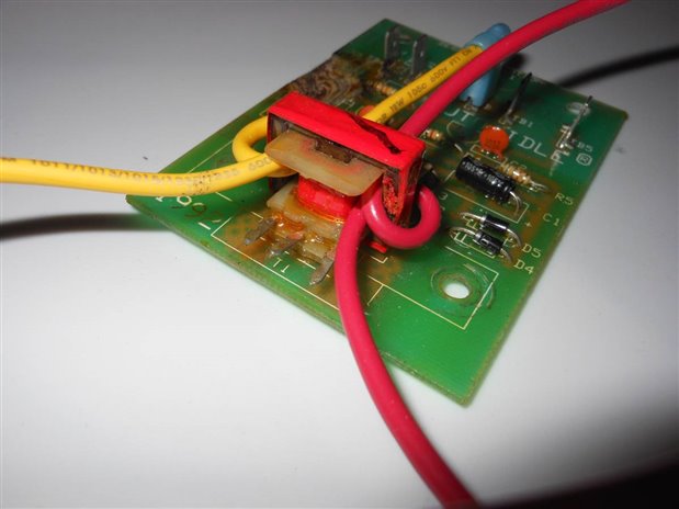

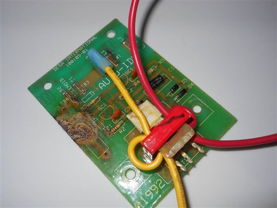

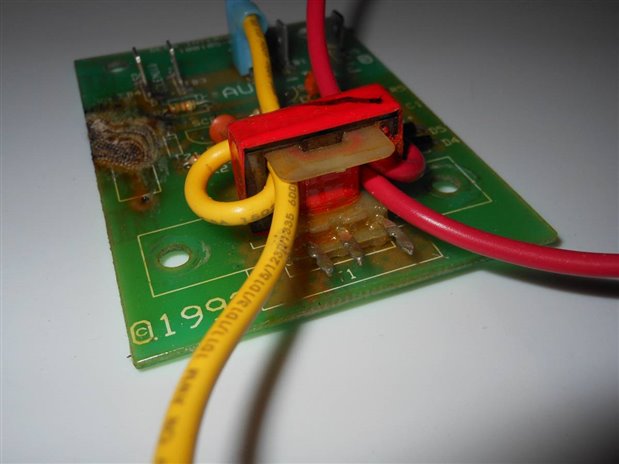

Hi. I need help identifying an early 90s PCB transformer. It's on an auto-idle control board from an early 90s gas-powered generator from a company that has since gone out of business. I'm not familiar with components but think I can identify all of the other components to remake another board in case of a catastrophic failure. The problem I'm having is identifying the size and type of what I think is a transformer. I've included a few pictures. It's located at the bottom of the board and has a yellow and red wire wrapped around it. The red wire comes from the generator head and goes out to a breaker to power the receptacles, and the yellow wire comes from a terminal lug next to another terminal lug which accepts the other (yellow) wire coming from the generator head.imageimageimage
And can anyone tell how big the small capacitor is that's located to the right above the transformer? I can't find any marks on it other than the temperature rating.

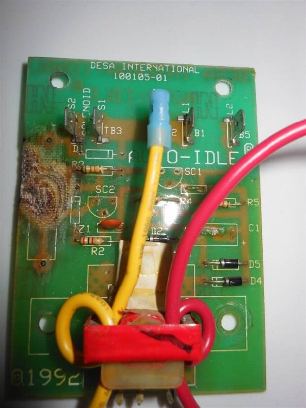

I also have to replace a 5W 82ohm resistor that blew due to a bad Schottky diode that I've found and will replace. Would it be safer to replace the blown resistor with a 12W 82ohm resistor? And can I use an aluminum encased surface mount resistor on a thru-hole PCB?

    Hi Chris, The small capacitor is probably marked on the side that is glued down. You may have to pry it loose carefully. You can up the wattage of a resistor without any consequence except that of a larger…

    I would agree with jw0752 that the small transformer is a current transformer measuring the load on the sockets to allow the engine speed to be controlled based upon the load the generator is supplying…

    The black electrolytic seems to be part of the power supply to control the SCR which then controls the solenoid, and I'm pretty sure this will be degraded.

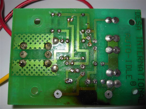

    If you were to take a good photo of the underside, I'm pretty sure John will have the schematic done in no time. image

    I may re-use the old ones but will these work? CERA-MITE .01uF 250v 103Z 12mm disk Radial Ceramic Capacitor? They're 12mm instead of the 6mm on my board... Would it be okay to squeeze them in? And how do I test ceramic disc capacitors? I only have an average digital multimeter but can check capacitance and diodes too. The two SCRs are MCR100-8 thyristors, I've ordered some of those along with a replacement electrolytic cap which was a 47uF 16v.

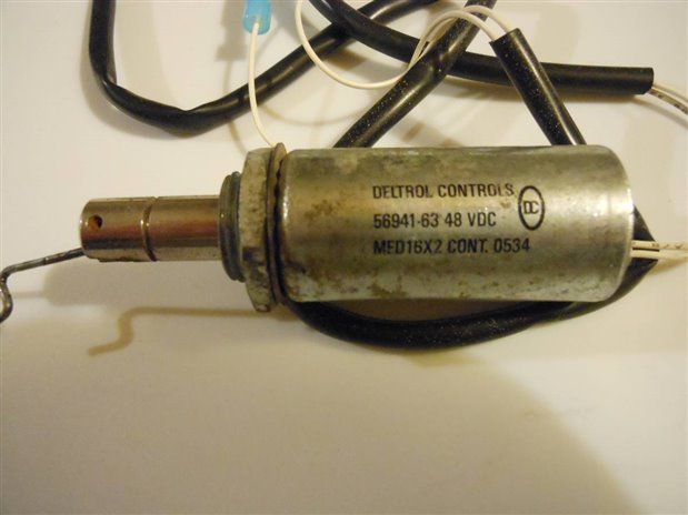

    Here's a picture of the back of the board and a picture of the pull solenoid that's hooked to the engine's governor arm that the auto-idle board controls. I've pulled a few of the components so is still some flux I've yet to clean off the board. The darkened area on the board is where the 5W 82ohm resistor blew and made a mess (I've cleaned out the carbon with a Dremel). I think I'll replace it with a larger 12w 82ohm resistor.
