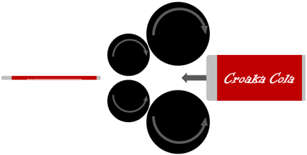

    Another thought on this, you could just use rollers to crush them flat; two sets.  First set to pre-crush, second set to smash it completely flat.  A single set would have to be considerably bigger to get the angle incident on the edge of the can to grip it well, so the two sets would be a method to reduce the overall size of the thing.
