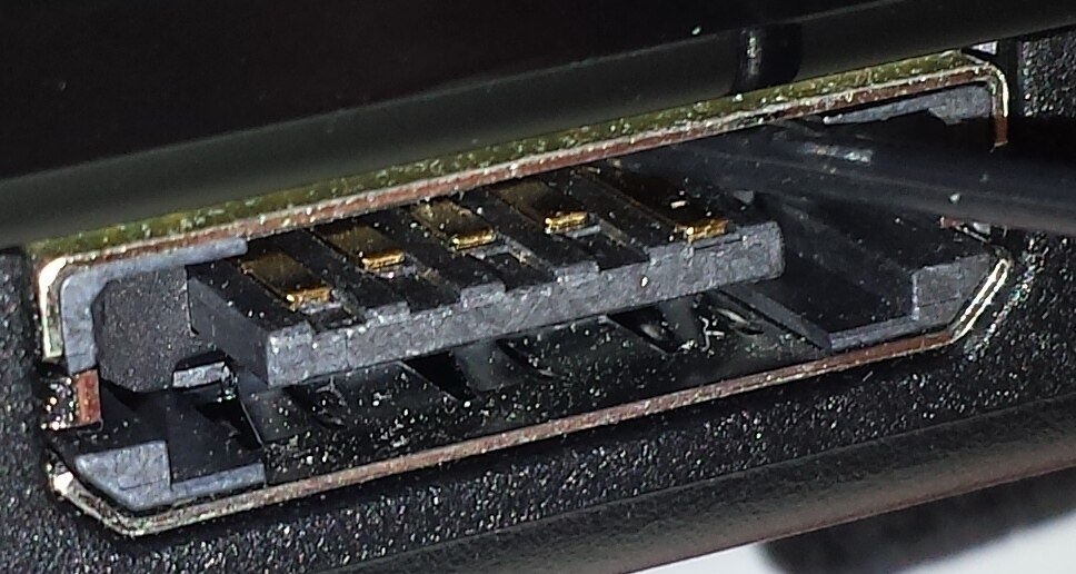

Hi all,
I have a personal project that needs to interface with a port that uses a physical configuration that is believed to be proprietary. To provide a stable interface with the port, I would like to prototype a male connector but I don't think I'll be able to directly measure some of the dimensions of the existing female connector because of the scale and unique configuration. Does anyone have experience with using a temporarily malleable material to create a form of a female connector so that measurements can be taken of the negative mold of the connector? Any suggestions on what materials or products might be helpful for this purpose?

    It might be worth taking a photo, in case anyone recognises it, in case it is not proprietary.
    If this is a personal project not in quantity, maybe just cut off the connector?
    Otherwise if you really need to take a mold, there are probably art clays, but as I understand they shrink
    slightly while hardening : (

    I agree with shabaz.  Post a pic if you can, otherwise, is there a model number on the female connector?  Digital Calipers are a must have in my tool kit to get dimensions, and that can help narrow it down.

    Hi, thanks for your response. I've added a picture of the port to my original post.

    0 shabaz over 12 years ago in reply to nbuuck
    It looks like a cross between eSATA and USB :-(
    It may still be a standard connector, but unfortunately I'm not familiar with it.

    Indeed, I found a lot of results relating to USB and eSATA while trying to identify this. The scale isn't evident from the picture, but this connector is significantly larger than any similar USB and somewhat larger than eSATA.

    Hi Nathan Contact your dentist as they have materials that will make an excellent detaled impression. They use an impression material called alginate to make impressions of prepared teeth so that they can have a crown cast. Once you have the impression you will have a way to get your measurements.

    Interesting suggestion! Do you have any thoughts about the potential for residue to be left in the port? There's a sliding cover that recesses into the port when the male connector is inserted that seems like it has a lot of potential to collect and retain the molding material (alginate or otherwise).
    I'm starting to think that maybe taking a block of material the approximate size of the outer dimensions of the female connector, conservatively subtracting material based on initial measurements, and using fine subtraction from the prototype material until it adequately fits the female connector. This would allow me to minimize introducing foreign material into the female connector by thoroughly cleaning the prototype before testing for fit.
