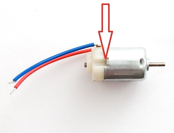

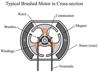

    Hi Will,
    I have been playing with motors like this since childhood, it seems that the Brushes of the motor have Worn Out or are not in contact with the Commutator, or one of the three Windings are not working.. I would suggest you open up the motor and inspect the brushes and the windings and also clean the insides with WD-40 or something similar..
    below are pictures for reference...
    Hope it helps you...
    0 e14 Contributor over 11 years ago in reply to saurocksall
    Thanks for your reply Saurabh, I'll have a look inside later and I'll get
    back to you.
    Will

  • saurocksall
    0 saurocksall over 11 years ago in reply to e14 Contributor
    These motors are not that hard to open as they are not glued or screwed together, the plastic half slides inside the metal cover and 2 metal  clips at the side, just bend those out and the plastic part will slide out from the metal casing..
    0 jw0752 over 11 years ago
    Hi Will, If you take your motor apart it is a good idea to put an alignment mark on it as you will change and polarity of it if you put it back together 180 degrees from normal.
    good diagram thank you for helping
