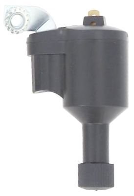

    dougw over 10 years ago
    You could try a bicycle generator like this - they cost $6 - $7. Or maybe a small alternator.
    However you will need a pretty powerful Stirling engine to drive a generator that develops any significant current.
