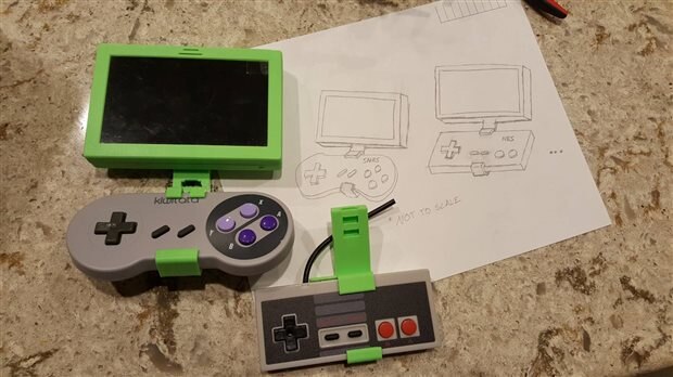

Project Update: March 23, 2018
     I have successfully realized my design ideas with the magic of 3D printing! There is still a lot to do, mostly soldering and programming.
Be sure to let me know what you think in the comments below ↓ image

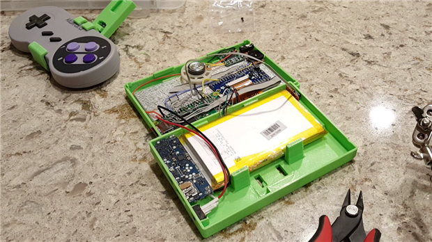

Project Update: March 28, 2018
     The soldering and programming is now mostly complete. This thing is really awesome. I spent about 2 hours playing the Ledgend of Zelda on the SNES last night. And it still shows a full charge on the battery.
**Quick Tip**: if you are using GPIO to drive the audio on pwm0 and/or pwm1 (such as on the raspberry pi zero) and you are getting an awful buzzing or humming sound on top of the audio. Then you need to check out this video. After a bit of a wait, it describes adding audio_pwm_mode=2 to the /boot/config.txt file. This enables the sigma delta modulation on the pwm gpio. As soon as I added this to the config.txt file of my portable, the sound quality instantly improved ten fold, no other filter circuit needed.
Let me know in the comments if you have found this tip useful. image

    How's it going Andy? Tidy build good job!
