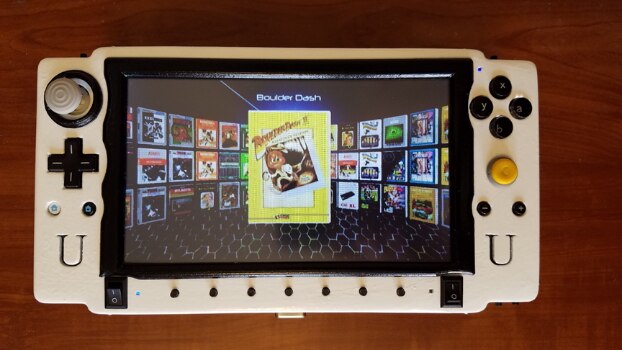

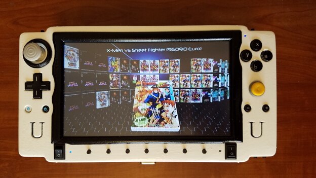

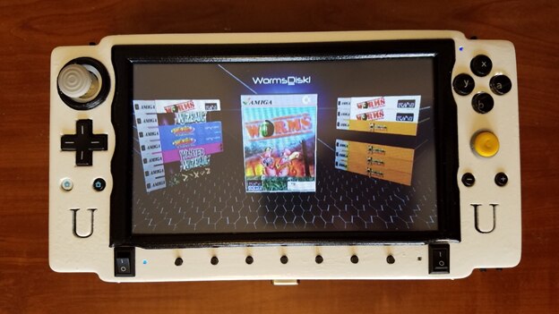

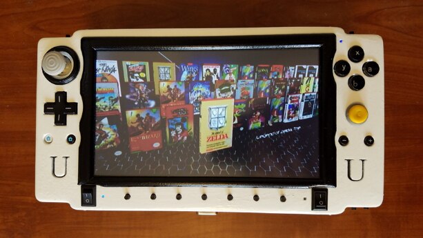

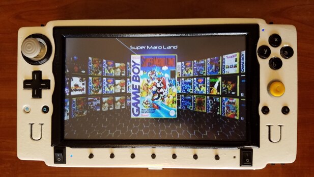

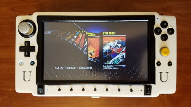

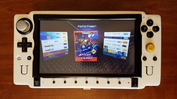

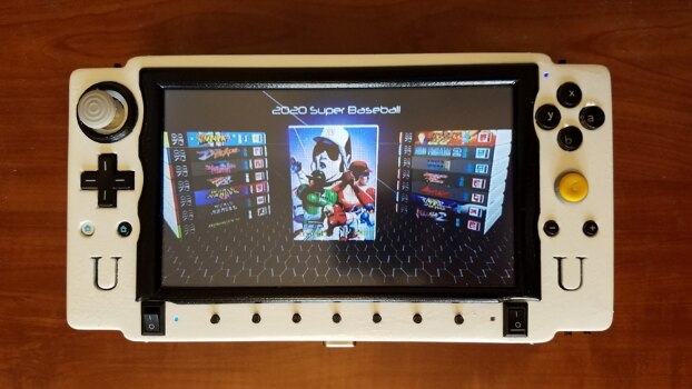

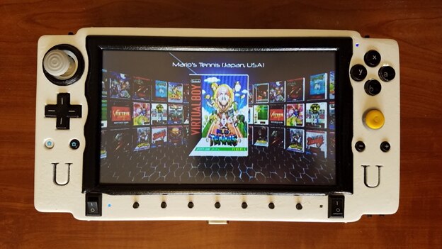

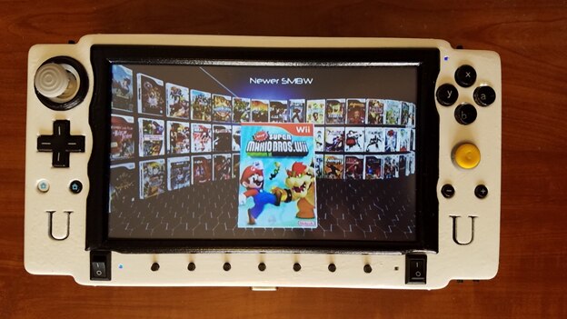

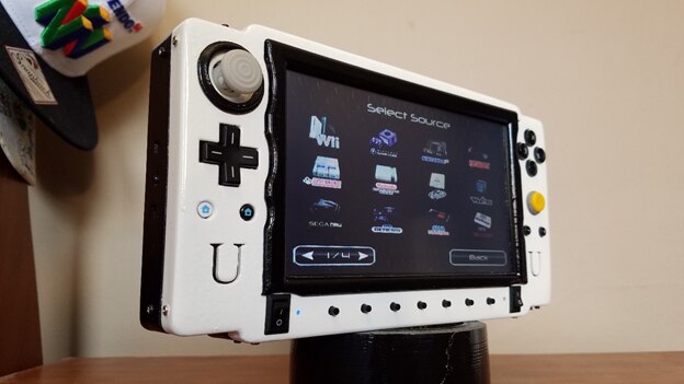

DESCRIPTION OF PROJECT
Watch the video, Its well detailed. Here are some other things I may have missed!

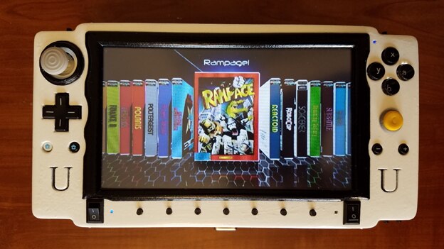

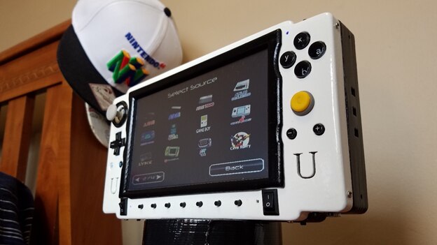

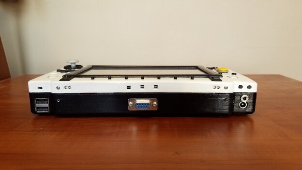

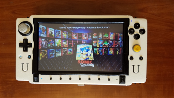

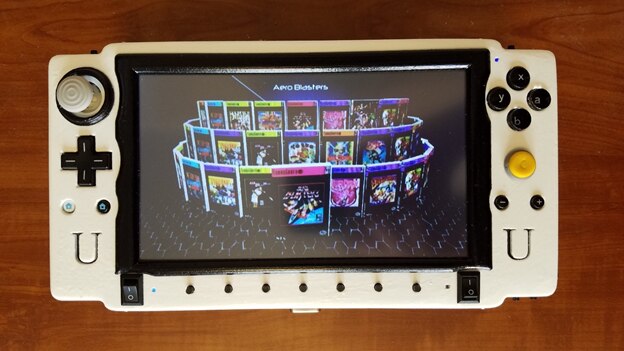

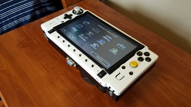

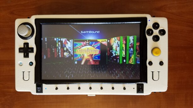

The Ultimate Portable measures in at 9 ½ x 4 ⅞ x 1 ⅜  and as you can see on the front, every little bit of space is utilized! This portable is jam packed with so many electronics it’s insane. I had some space left at the top left by the batteries, but that is because I trimmed  a bunch (that wiimote not so much, I'll have to find a better way to make that smaller) ran all the wires the best way I thought. The Wii is located at the bottom left but you can’t even see it because there’s so many wires in this. If you look closely enough, you can see I used 34 gauge wire for a lot of it, and a ton of wires are organized electrical tape and wrapping magnet wire.

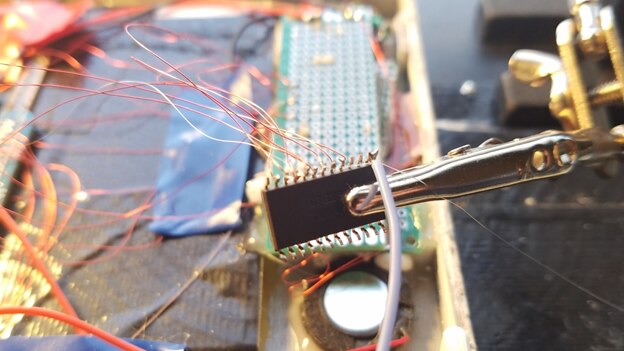

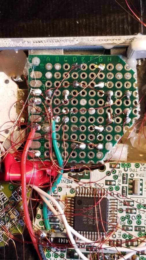

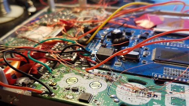

The four controllers process explained!

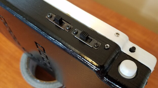

I said before how there is a Gamecube controller, wiimote, nunchuck, and classic pro controller inside. If you connect all together, there will definitely be an issue. The brains of each board get so confused and random inputs are pressed without being pressed, even when all but one is turned off. It was chaos trying to figure this out, and the only result I could find was have power, ground, and every single input. That would mean about 50 switches…so no. I took the IC route and found this chip (1ACEC2T CBT3384A). Datasheet basically says 5v in, GND, and in outs, but there are 2 voltage in points that when fed, it disconnects the pins. When powered, the internal switches bridge and connect, when off, they’re disconnected. I still had to use 3 of these ICs inside, cause the input amount and controllers. This is also how I can switch the D pad Settings on the system to change from holding the wiimote vertical to horizontal. Heres one of the ICs. The blue light on the top right of the system near the abxy buttons shows blue for game cube, green for wiimote, and flashes when syncing internal wiimote.
Once the DPDT switch that powers gamecube controller or Wiimote is set to Wiimote, I press a buttn, and the wiimote syncs. If not I have the wii system and internal wiimote sync buttons on the bottom to connect it (and external remotes), the 3.1v going to the wiimote is sent to the 3way DPDT switch, and a data line to send to either the nunchuck or classic pro controller. To avoid any power confusion and glitchy controller cpus, I had 2 forms of GND in the System GND, Universal and Wii Controllers GND.

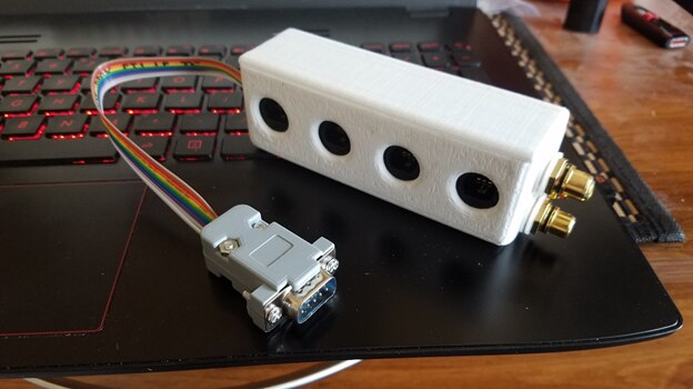

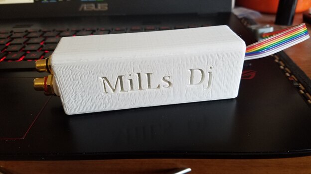

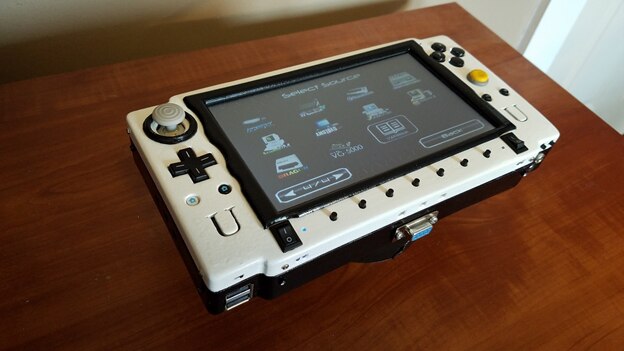

The Control Box
All my portables have a control box for playing the system on the TV like it would as if it were unmodified. It’s a quick and easy pinout for this and expands the gaming horizon back to the classic view of how it was made to be played….or maybe I don’t wanna go outside and play like a couch potato today ok ?
I can sync wiimotes wirelessly and the other usb port on the system itself for connecting usb controllers, so there are only gamecube controller ports to use.

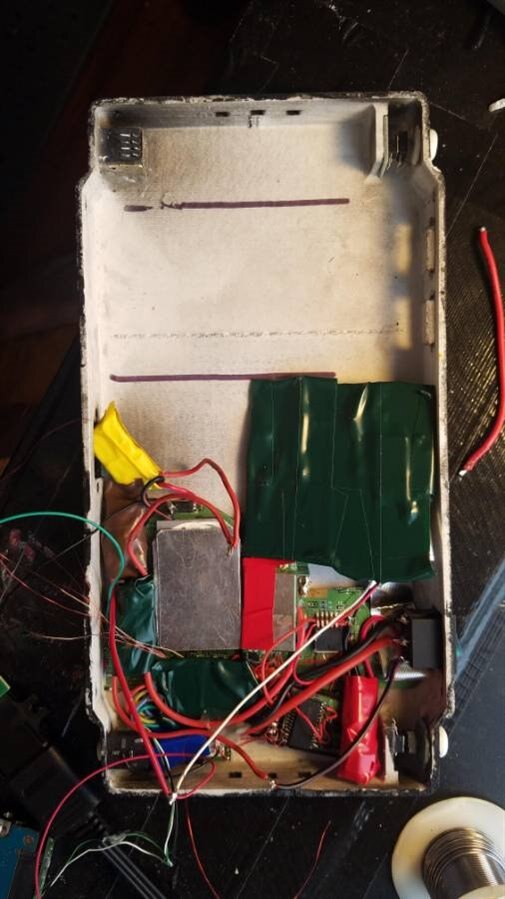

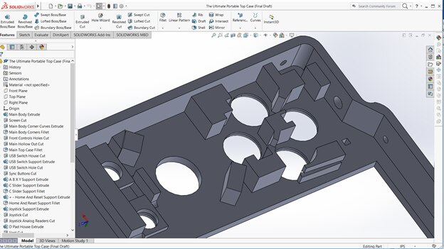

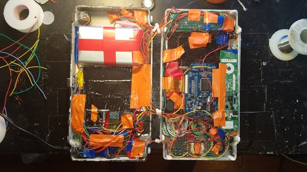

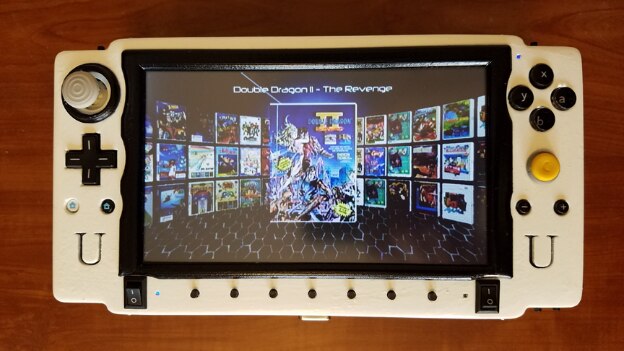

The Case
I measured all the components and developed support on the inside structure of the case to easily load. A lot of people vaccum form, cut the actual parts of plastic they need that house buttons and components and epoxy it on then sand, but this portable is the first of many. Now that the main case is on file, I can adjust it to be easier to make the next one. Once it is perfect, I can just say to HACK with it and press print on the 3D printer and boom, a case. (and paint the way I want it too) This is Prototype 1. Definitely making more.

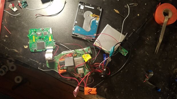

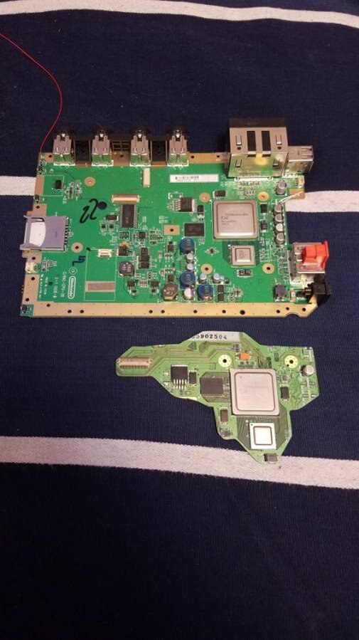

Wii board no trim vs my trim, and then all the parts wired up!
SNEAK PEAK OF THE GUTS AND GLORY (3/31)
