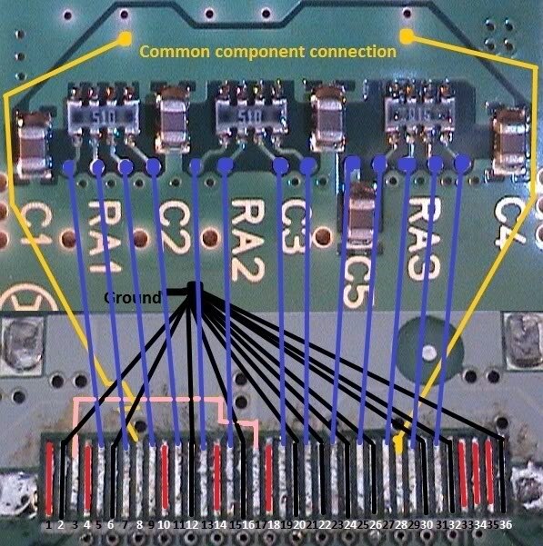

    yGHnWTlfKCDBjG-JQK3iYFDy5OrCNI9pmxADL9JATkZBPHjXGX92zGI1_YV0m_4Ew6AbU4lZQZ4aCHtkzlhRp-b-wpZopSQ3IfB1FeY3GRI_C6MAlb75i5EI6ojCv82z2EDaoVis1pQGpmlvdOABVTwbW1QORXmgQWWOTXvVt7u4XxXe79G6SpURnP3J-i_eIvCdQ6wyedvC5mPASP1-3Un3a-mSyb63HtKHhp-uJ9il_zW5rEJn7hlVdkfijgYqhjQ4REgMTzARI3l8bk9SQWETsrCAriuhfHpJUYVlFtR-c3NvY57Z9OGM_utKTwLMHDEgBH9ryTGZASCdHLMgrzm-Kn4jdsvpMfSR3PEGsRw1JoeXQFGqp3fM2jlHc2DnF2vcB9Jne6teI40_uF55aCQXbEIVa-KmHxK6rb7Mce5JODvt5HNgOMEXFdOI-1IWZxTYqBKM4ZlmGJNjelyeR6XkchrpMaaHydlIcqZxhMjO2e-Tj9iDW3Yq06MJTqvydofONftCohtBsaUDJj5cXwbMDN-r0a-Qa1_t_JkO8pJNE9iGKh08pi3BfFA_mHUq_X10gwoeiYG9j_qKTbMLfnmpyAtZhqMojY2rxQPKRijQikvyK_7QArdJXvfX5SfL39wE-PXd8F8xikOTp7EfpuJ3QPWDCZeo89Y=w1835-h1376-no
    I did a attempt to get the jumperpack working with 2 x 4mb ram.
    this works just fine.
    PAL Board
    - swap the 2 x mb with 2 x 4mb
    - remove the port
    - cut the solder pins from the memory expension on the board, i used my soldering iron after cutting and removing the traces was easy
    - wire up data lines to 5, 7, 9, 11, 13, 15, 19, 21, 25, 27, 29, 31 to the 510 resistor packs
    - wire up at least 3 caps to ground and backside to the common line of the backside of the 510's
    - wire a wire from pin 3 and 17
    - wire the via holes from the pins 8 and 28 to the backside common line of the 510's
    - wire a wire on the back between c311 and c71
    3PlWRgrr590YOwSMONJVlt9cC15lcAk-iMpTMlyfICKsM1WTkcFGdpK9d7eIY0-KzLnHGoc4VascuAfjb158foD-XMwFfOUcmH_Lfv94NbJbA0NtyrBoBQVzz5EtaMnIjEfra723UdOFsGO2y3O9mc8VOPlXngg6OQphnZxmgK_tpMRqh5zyulXbR2VxPmRgKe69b4xPaUbq3L58DfnB7CoZivNIhlJTP3p_gRgT7vmXfbllTg-OCD0RiygQJVz-hxp5-Wo9svbRXyrB-y7mBNJ_u9iYwlbhLMctjVOg1VF23XK1c_j8elz_bJeAtDRP5JAOb6YMPW76EEI-0PrKezii0DJvn9PxKT3jHWJzLPl5Sg5CMGHom058Eyp4X5mkElja-tqbyBUg2-ZWBLbH_gFpTvz7uO6epBZ2SWE90TyKjjou3m9OMJELPEkSKQCi8MGA9Vn1nm8NDIwdyBidVtaiPIKPrCTlwIFHghqEHMAxtpzG2ErW0u48fpMsCzbp8k-JsRXFzkYs-J9aBXKLW8aLytpE7DL7AoPGqvmTxKaC7eXfUKzHhXlvQdbxklc3Cun8zOrbDSOSJY6ogaX2w0Cr0IUJ_TbIK480kFS-r6uMEbAiSTTLc9pKk2SvjxfuBIL_GGSRllca3LJB93mjkdBT00X0A0AfIzU=w1032-h1376-no
    all working fine and you can add your heatsinks.
    98lyrjr8MVqAVXmEMdPwKMJBRIHhXPr8W0gP6WIC5lRk3AXp-Kfw1an21xXvhZT4a2b_l4le-KvkzXQ_kWNtFtpp3VMRRv0gcwwTgb-mQ-shlS00XtvBF98_99JJi4D2VMx67ayvLUMWnWMPFaqv11r1enTxDS8wPNVilA1NAHnDDqeoVXAe5IWJEhljh-x6sC27whi-xDsw6m8Jt-U8DenKEnM14ReygMXNFDY5n5DmMXxsPzit162GXNIVd7jMn3oWKdrntgAWrrGEKOMkx7NJ2fZYn6zaX_95ZtQXpMZpyIKisSOXrvVmcTgqZvaDR8oz2qGwMJTgJJJu_WVxfBnClgqyeLLeX1Vv8G1OKxWlgHTmAxg_mbu5uIAiwCYRClkI_LHwuz8aMmev8nKreNZkaB_zopeCfy9n0LugRm5bExlUQ-fujP9cTLx5Z5hII8NPe0ks4JRnpnmoj4NDSEOvEaBfntfOdp9NUFjF5s3NMD5Gwc9TsUwAHbLMUFxS5wRrgzhrZgdpNKArgOI2IQV2lxbUV0RThEFHaTmKsHaHNLSn8TGP00zNSEaPV8R2I1VTacmt_sfzA_GM4OxJy247TD_sF-BJL-Rs9507sgwvebu8TeCXAIczyHeJtjMy-MSIIu87b1_8DyeD-7gBIuW_HuY5cyflXFw=w1032-h1376-no
    screen is black and white because i wired composite out to Green plug  on YUV port
    reverence pic from modretro forum user Bentomo

  • eb1560
    eb1560 over 9 years ago in reply to akiramods
    Nice work. image
    This mod essentially removes the electrical stubbing extended onto the jumper pak.  You are essentially shifting the transmission lines to a higher impedance upon termination with those wires, just like the back of the jumper-pak.  Have you verified if Vterm is properly bypassed in this setup?
  • akiramods
    akiramods over 9 years ago in reply to eb1560
    How can i check vterm?
    Tomorrow ill add some original heatsinks and let it run a few hours
  • eb1560
    The thin wires (VTerm and ground, not the data lines) connecting the resistors and caps are cancelling the ability of the caps to smooth out high frequency noise.  An oscilloscope would be very handy in this situation, but it might be more practical to have a highly stressful game (Perfect Darl/Turok II) or rendering scene run for a period of several hours - this would give an idea as to whether the RDRAM and RCP can tolerate this circuit design.
