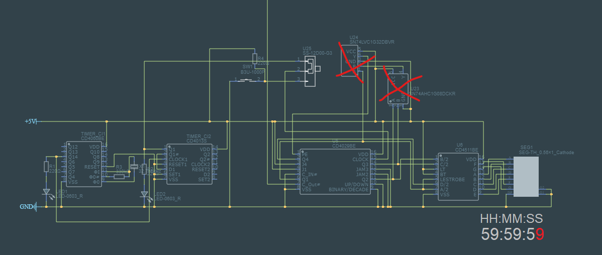

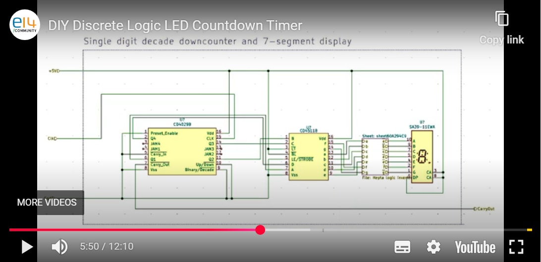

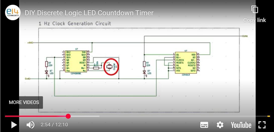

Hey everyone, I'm trying to create a countdown system, but I'm having trouble understanding how everything works together. I'm not really sure how to chain the parts properly. Could someone please show me a clear schematic or example of how to connect everything step by step?

    Start with the clock circuit: and connect the 1Hz output (top right) to the Clk input (middle left) of the 1's counter: Then connect the CarryOut (lower right) to the Clk input (upper middle left…

    Yes, but I think you need to remove the reset logic on the 1's counter for the minutes and the 1's counter for the hours as they will need to show 0-9 and not 0-5.

    It looks like you are almost there. It is perhaps time to start building a prototype on some breadboard to help understand the circuit. If you start with one decade counter connected to one display driver…

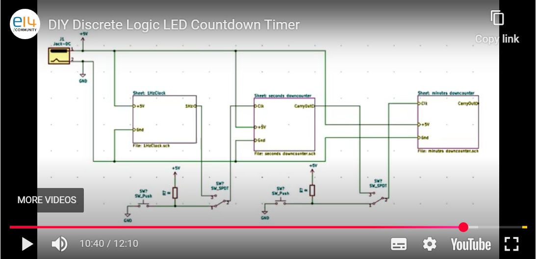

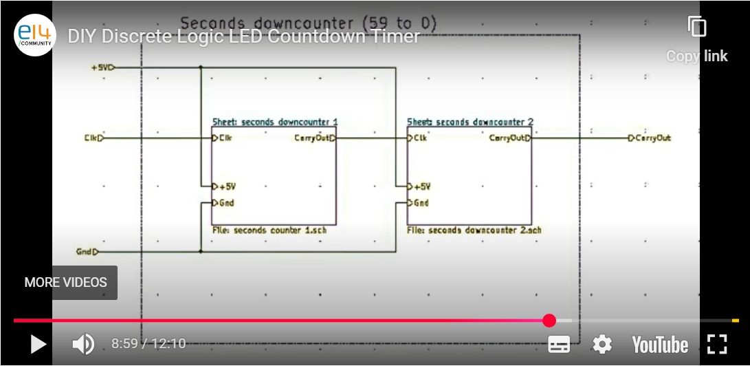

    Then connect the CarryOut (lower right) to the Clk input (upper middle left) on the 10's counter:
    The cascade connection between the two counters is shown here:

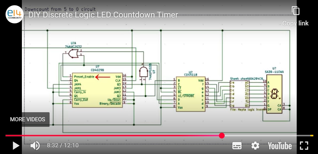

    To add the preset option you need to insert the switches between the clock 1Hz output and the 1's counter, and the carry out of the 1's counter and the clock input of the 10's counter as shown here:
    which disconnects it from automatic clock operation and allows you to clock it manually with the push buttons.
    Note that the display digits are in the reverse order here. The 1's counter display is shown on the left on the schematic whereas in the physical world it will be positioned on the right.

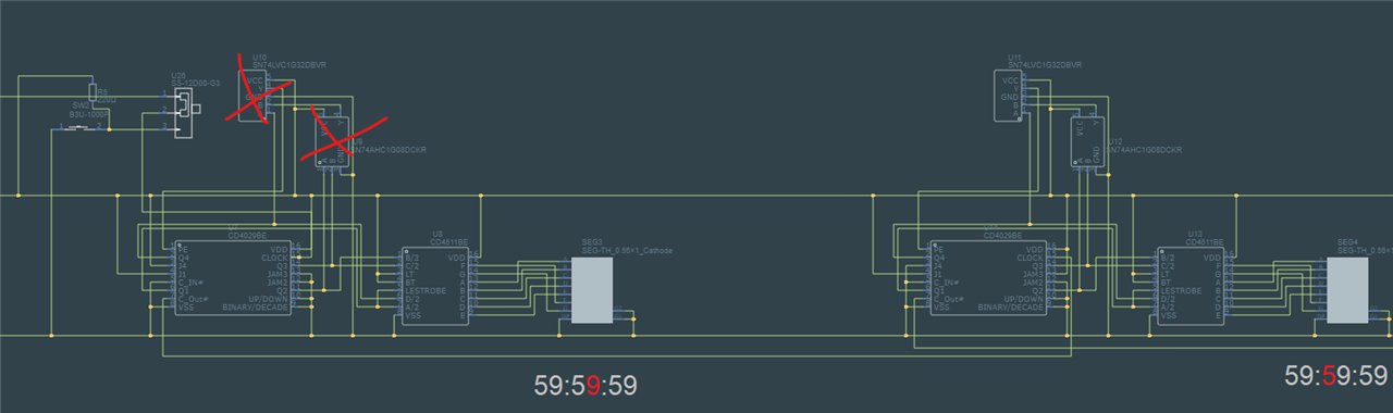

  • evo
    0 evo over 1 year ago in reply to beacon_dave
    imagelike this?
  • beacon_dave
    0 beacon_dave over 1 year ago in reply to evo

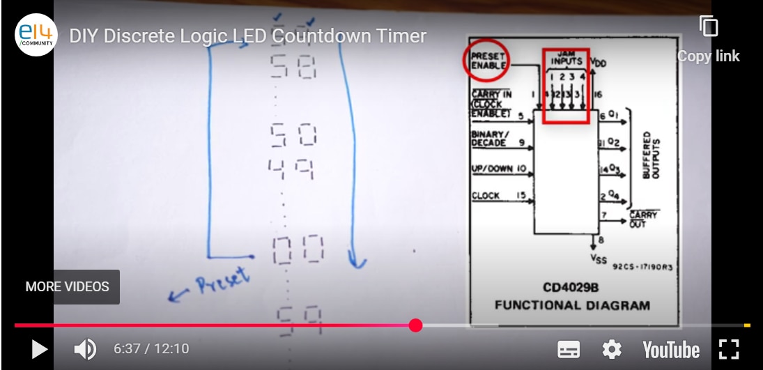

    is that binairy?
  • beacon_dave

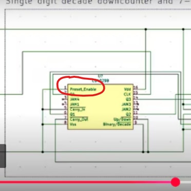

    BCD (binary coded decimal).
    The  JAM1-JAM4 pins set the value you want to reset the decade counter to, so in this case it has been set to the value of 0101 (5 decimal).
    The reset is triggered by the combinational logic attached to the counter outputs Q1-Q4.
    When ( Q2 AND Q3 are high ) OR when Q4 is HIGH the counter is reset.
    The logic added will therefore reset the counter to 5 whenever the counter outputs a value of 6,7,8, or 9.

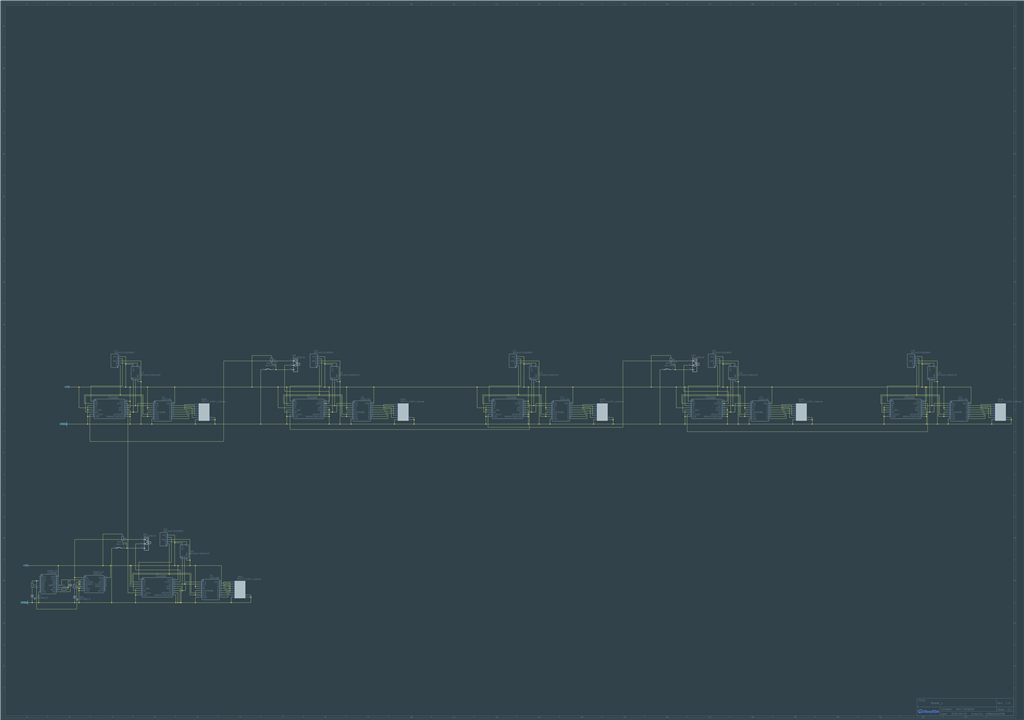

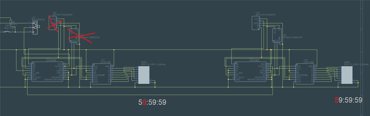

  • evo

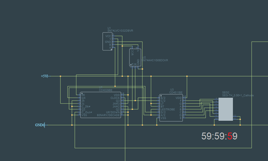

    is this good?
  • beacon_dave
    You probably want the switches on all 6 counters so that you can set each individually.
    You have too much reset logic. Only the 2nd, 4th (and potentially 5th and 6th) counter needs it.
    The 1st counter (seconds units) drives the last digit so it needs to be able to count from 9 down to 0
    The 2nd counter (seconds tens) drives the second last digit so needs to count from 5 down to 0 so needs the reset logic.
    Same with the minutes counters.
    What is the maximum number of hours are you wanting to count down from as that will affect the reset logic. No logic and it will count down from max of 99hours.
    The same logic for the minutes and seconds and it will count down from max of 59hours.
    but you could change the reset logic to make it from max of whatever you want.

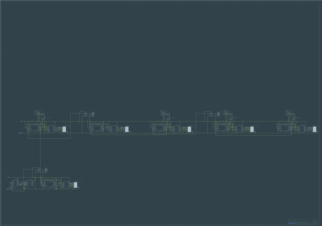

  • evo
  • beacon_dave
    Where you have removed the logic you probably want to pull the preset enable pin low rather than leave it floating
    as per the original schematic
    If you start with one decade counter connected to one display driver you can clock it manually using the switch and watch the results on the display.
    Build a second decade counter circuit and add the preset logic to see it counting down from 5 instead of 9.
    Then join the two together to see the cascade working.
    Build the clock circuit and test it counting down from 59 seconds.
    Add in another two decade counters for the minutes display, and then another two decade counters for the hours display.
