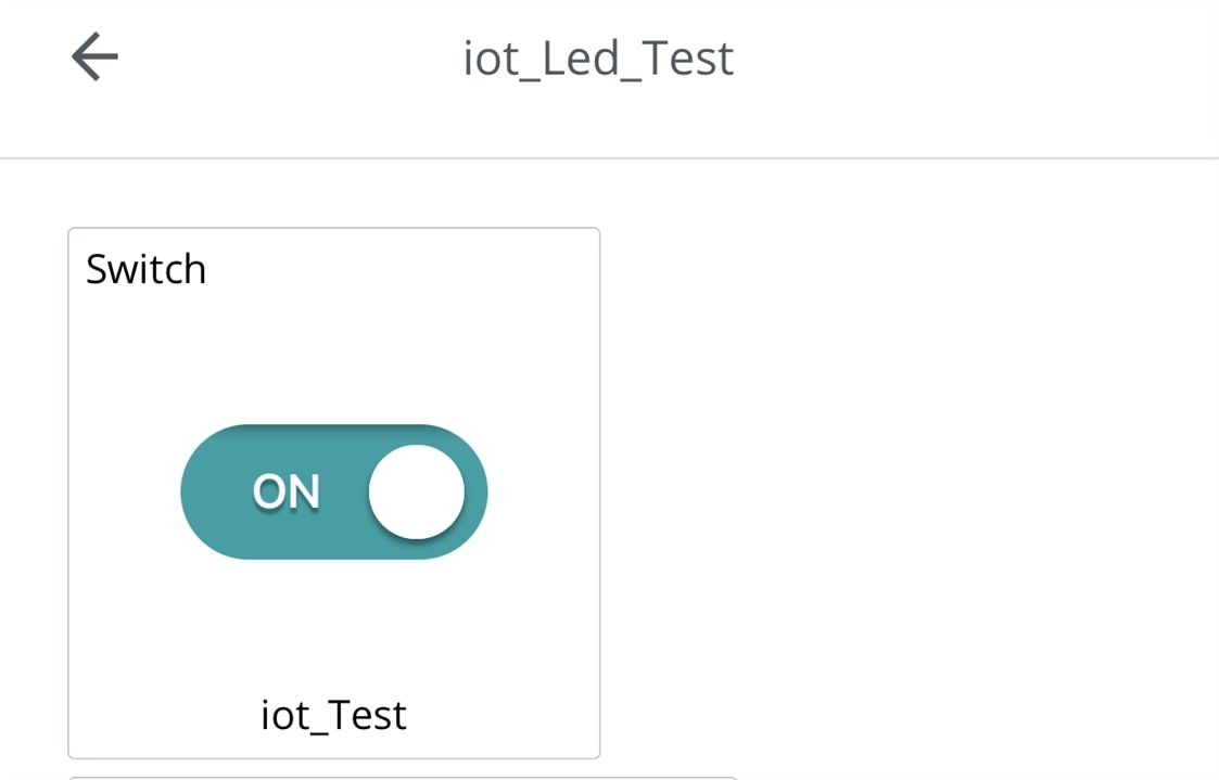

  • mario1015
    mario1015 over 4 years ago in reply to DAB
    hi DAB, as a first experiment I made a LED light up. WORKS!! Now I go on to do less trivial things. the DHT11 is only powered, I haven't connected the output yet. greetings to all.imageimageimage
