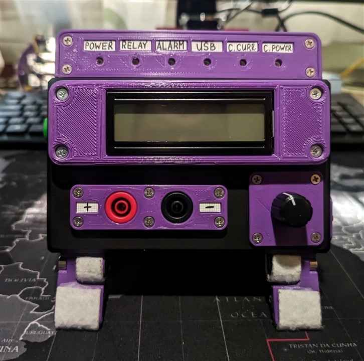

The Enclosure Design
The only thing left to do was for Milos to design an enclosure. Deciding to start with an off-the-shelf enclosure and add 3D printed parts to it. Milos wanted a 16x2 LCD in the front for displaying information, LEDs for signals and 4mm banana jacks for connecting what’s being tested. This steered the eventual design. You can see the full design as well as the finished device below.

    The LCD panel STL(s) are missing from the download
