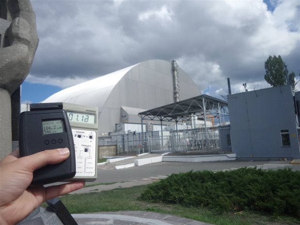

    Loved the video, I work in Radiotherapy so work with Man-Made radiation, but have also been to Pripyat/Chernobyl etc.
    I've designed and built my own Geiger counter, which I've called the DMGC-02. Been working on it for a few years, features GPS location, SD logging, Nokia LCD display, rechargeable Li-ion battery, Micro USB for charging and Serial data logging. Runs on a PIC, rather than an arduino, but I recon you could easily incorporate some of the features I have. monitor the output voltage with a resistor string and use PWM to control the output to the HV driver transistor etc.

    No worries, I'm quite happy to tell all about my time in Kiev/Pripyat/Chernobyl so please ask away, either here or in PM's, I'm sure others would be interested too! I'm actually in the UK, but there's loads of places in the USA that I'd love to visit. This counter has been to the states with me before and I've GPS Mapped a few areas but not found anything fun, I'd love to visit and do some mineral hunting for Uranium ore etc. I'm visiting San-Fran and Vegas, in a month or so, I really want to take a car out to some of the old mines and have a dig in the spoil heaps!
    I get what you mean about just getting something working, I've been there before. It look me long enough just to get the LCD display working on my project, then it skyrocketed from there.
    Re: the Woodpecker, or 'Duga' as it's known, yea I visited there on my trip, it was actually half of the reason for my visit, I really wanted to see the structure as there's some mutterings that it may be sold for scrap and torn down in the coming years. That probably won't happen for a while but be aware that it's possible as that area isn't really contaminated at all, despite it's proximity to the CNPP.
    I made a huge album on Imgur with my photo's in it, if anyone would like a look through.
    https://imgur.com/a/4hvGU
