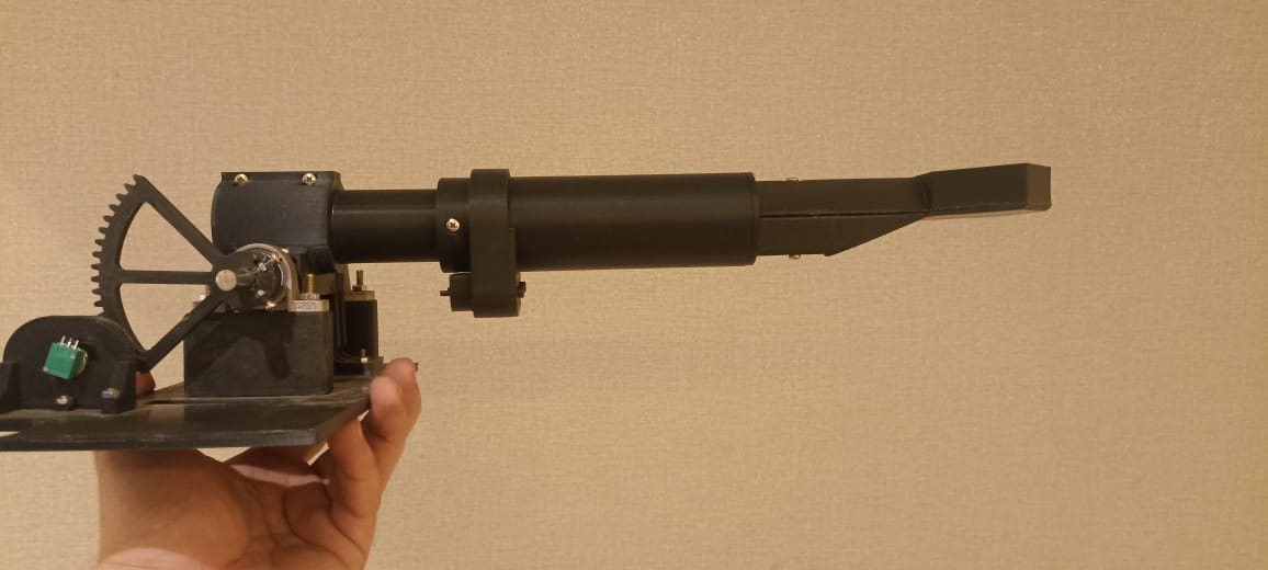

    One good project, it's one project that you can modify So I changed my mind, I use now one hall sensor AS5048a with 14-bit resolution ( Best resolution and linerality ) I changed too, the place of friction…
  • benaim
    benaim over 6 years ago in reply to benaim +4
    Pictures coming, better later than never So I used on SS495a, and to have one big range of value for "only" 45° of move, I done one adapter with 2 magnets. With this I have near 0 to 5 Volts on SS495a…
  • benaim
    benaim over 6 years ago in reply to KalebTheMaker +3
    Just received my two Bore Diameter ball So, now I can continue this project Kaleb, Thanks for sending a diagram to all followers I don't need because, I changed somethings, for example angle sensor and…

    Hi, I was missing a built-in accelerator like the real thing on helicopters.
    Since I use it in MSFS2020, I felt the need to change this already pretty cool design.

    Hello, I'm just getting started. But I took the liberty of making some changes to the project. I added a throttle grip, with a potentiometer in the center of the tube. The wires are now on the outside in a curved rod (channel).
    I'm printing everything right now. When it's ready, I'll post the results here.
