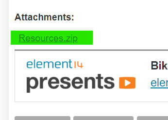

  • MwanyamakiJr
    MwanyamakiJr over 4 years ago
    i can't see the project code file.
  • beacon_dave
    beacon_dave over 4 years ago in reply to MwanyamakiJr
    Did you look at the Resources.zip file above ?

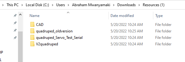

  • MwanyamakiJr
    MwanyamakiJr over 4 years ago in reply to beacon_dave
    yes, but i see other files that are not relates to the project above, can you send to me please

  • hifromkatie
    hifromkatie over 4 years ago in reply to MwanyamakiJr
    Sorry, I looks like the files have got mixed up, I'll just see if this can be corrected
  • hifromkatie
    hifromkatie over 4 years ago in reply to hifromkatie
    Whilst waiting for the files to be updated, you can find them at the GitHub link
    github.com/.../Speedometer

  • cstanton
    cstanton over 4 years ago in reply to MwanyamakiJr
    This's been fixed. As mentioned you can also grab them at the github link.
