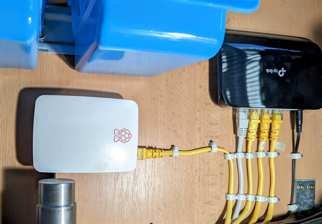

Milos has three main components to this project; these are a server and two nodes. Identifying that the server would benefit from being low power, Milos opts for a  Raspberry Pi 3B+ (though any Raspberry with a wireless LAN connection will work), while the nodes will be a Raspberry Pi Pico W and an Arduino MKR 1000 (both could be done with a Pi Pico W, but Milos notes that the Arduino has already been a part of the project for the past five years!). Going for a standard protocol for the components to talk together, Milos uses MQTT, with the server running Node Red.
With Milos’ decision to use MQTT it requires a broker which will be set up on the ‘server’. Using the Raspberry Pi 3B+ it will work as the message coordinator, so all communication goes through it. Any connected nodes can either subscribe or publish data to the ‘topics’ (which are like messaging channels) that the MQTT broker controls. You can find more information on setting up Node Red and Mosquitto for this project below, be sure to check the official documentation with the latest downloads.
After setting up the broker Milos quickly has a way to receive commands on his nodes and a way of sending the sensor data to the server.

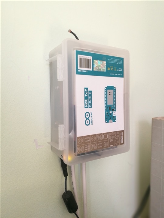

The Arduino Node
Again, please be aware that this project can involve working with high voltages. If you are not experienced or qualified to do so, please do not attempt to replicate this project without guidance and assistance from a suitably qualified and competent person.
Milos blogged about this part of  The Smart Room Project - Current Phase  in 2019 (code included in link) , using relays, motor control and blinds. This part of the project works by running a small server on the Arduino MKR1000 detecting requests and commands, the node also has a small infra-red receiver for infra-red remote control.

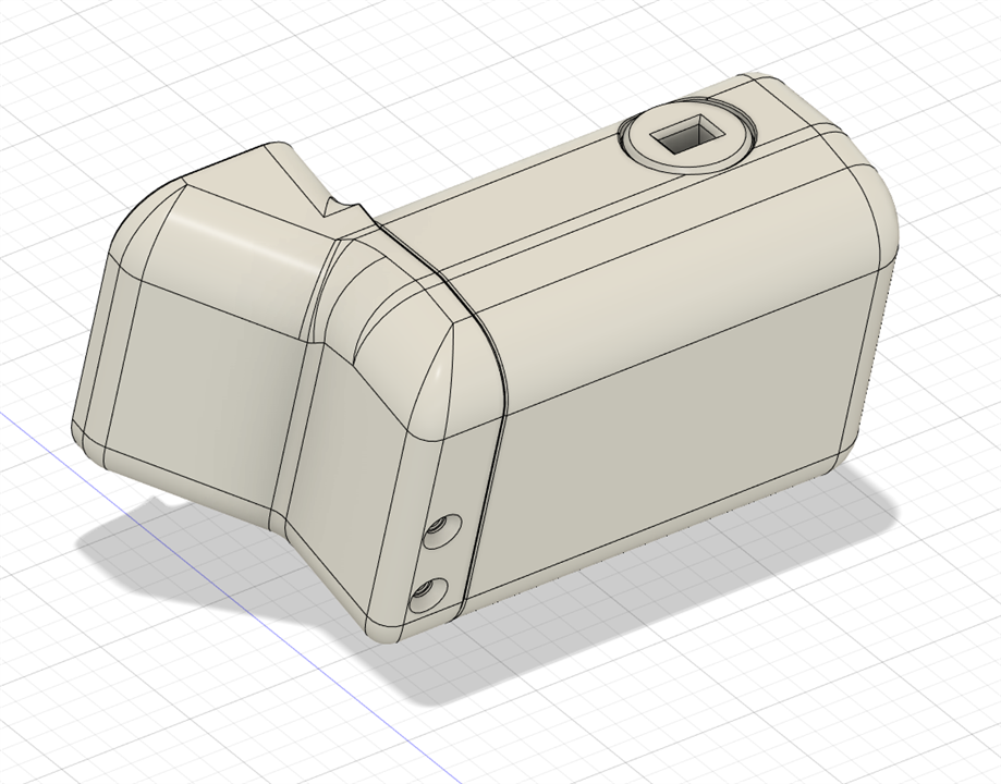

On top of the existing project, this is the new addition that Milos will be adding to the room automation setup. This node will control the venetian blinds on both windows in the room, open the right window and monitor the ambient temperature, humidity, and CO2 levels. Milos mounted the node above his windows where the curtain will hide it which will also reduce the needed length of the cabling.
{gallery}My Gallery Title

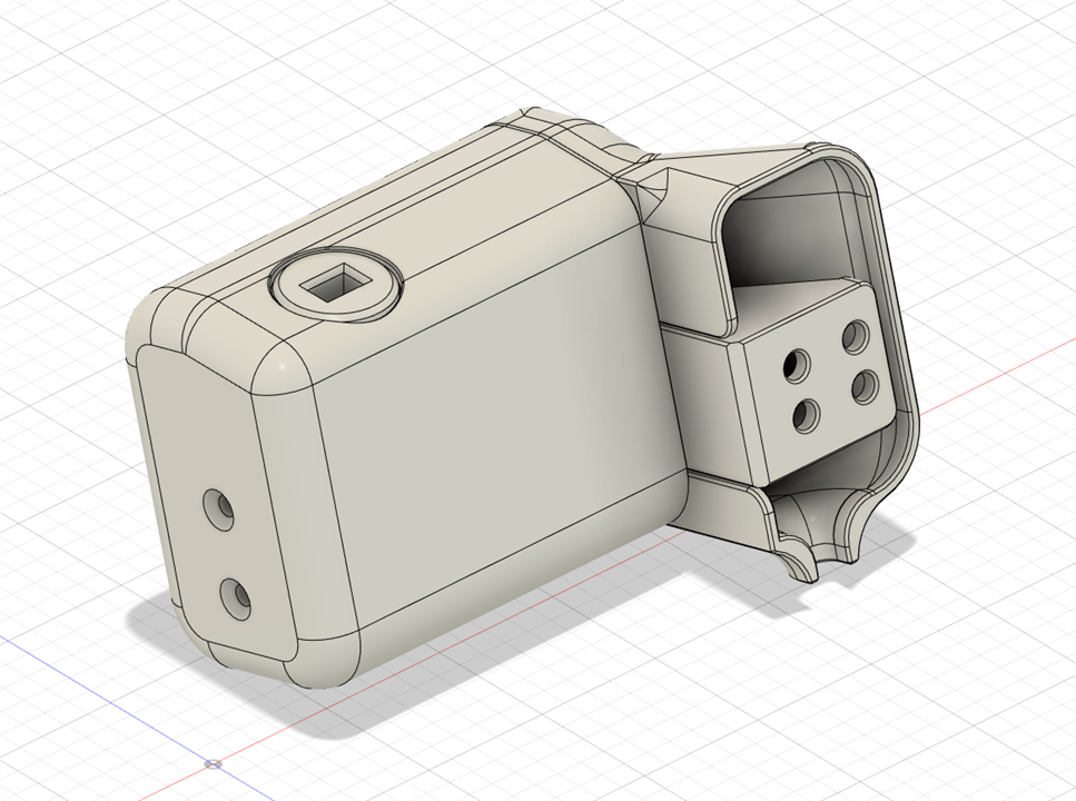

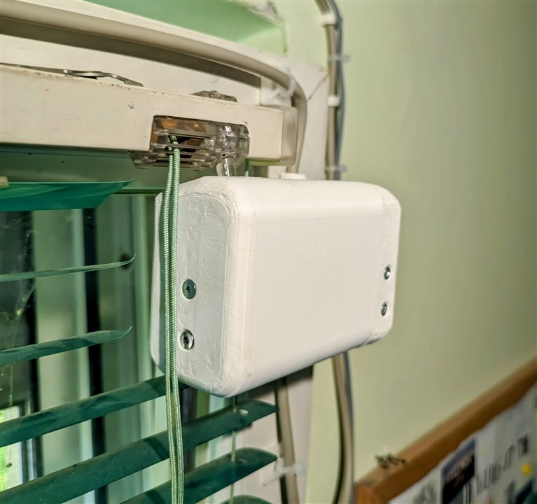

Controlling the Venetian Blinds
Designing the actuator for the venetian blind control was an entirely new experience for Milos. The ones in the room operate by turning an axle a few times in either direction, changing the angle of the light blades of the blinds. To accomplish this, Milos decided to use a 360-degree servo to ensure control of the range of motion in either direction. Adding small dimples to the blind’s coupler, it then triggers a micro switch which is used as a makeshift encoder.

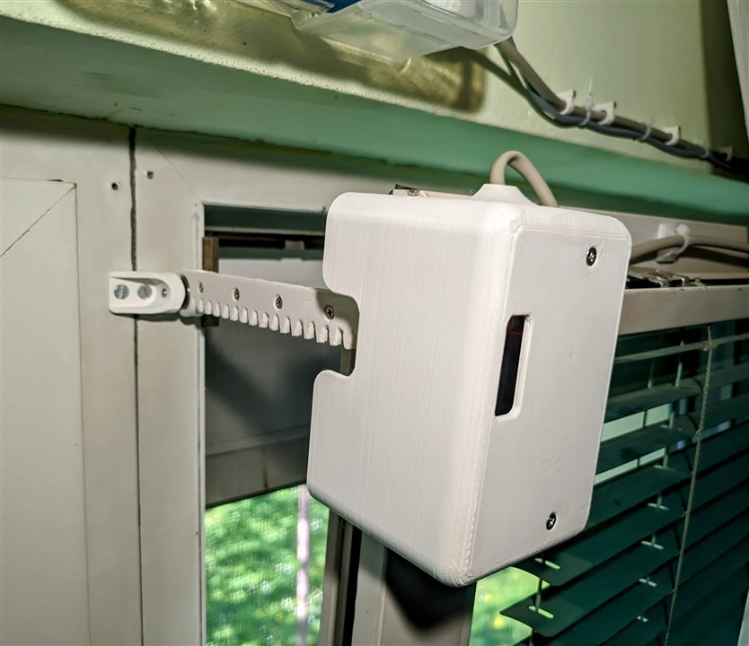

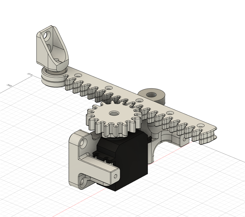

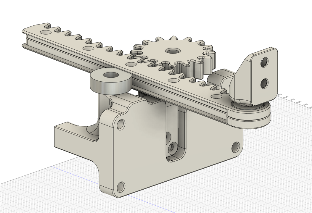

Setting up the Window Control
Controlling the opening and closing of the window required setting up another actuator, deciding to use the same motor, but this time requiring linear motion. This required setting up a rock and pinion mounted onto the window frame. When activated, this causes the setup to move and open and close the window as it navigates the rack gear, also using a micro switch for limit detection

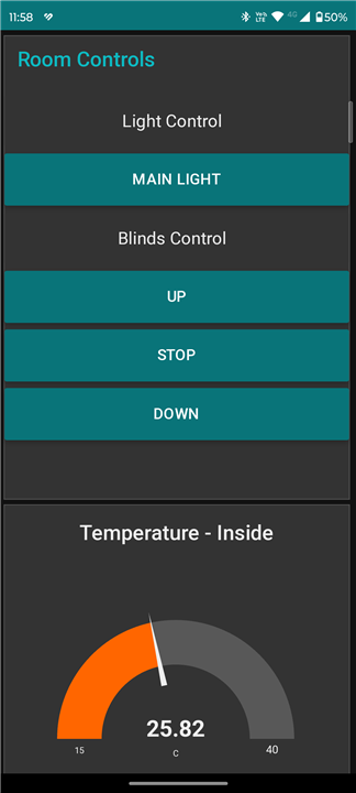

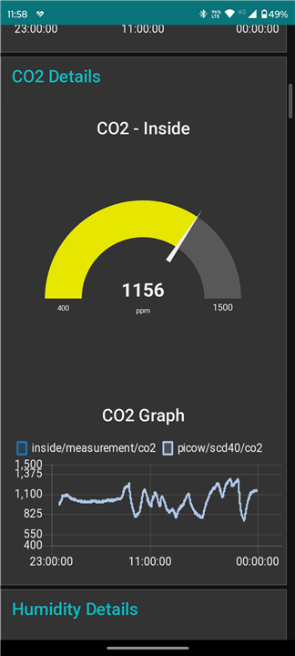

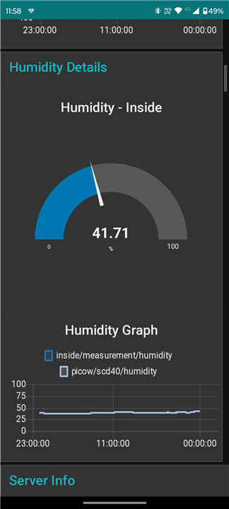

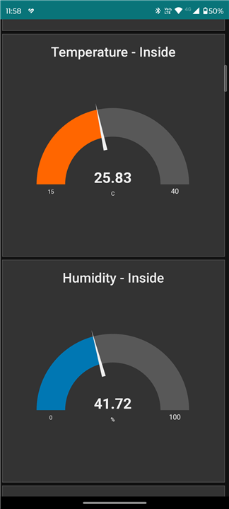

Setting up the Interface Control

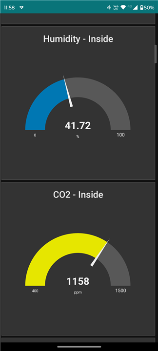

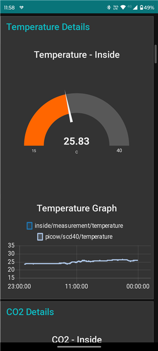

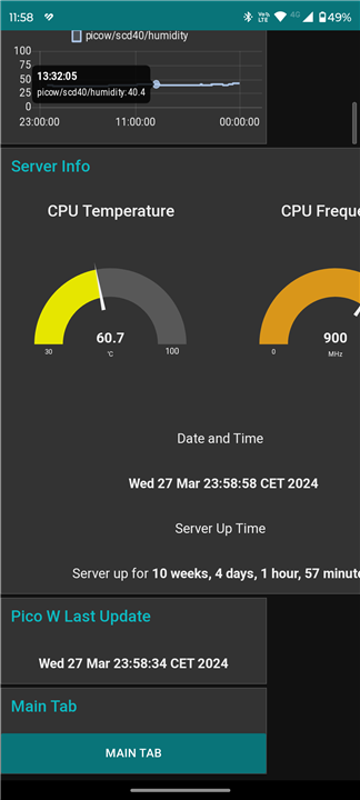

Since the server-side is programmed in Node Red, it has functional dashboard elements! Which are incredibly useful for making simple graphical interfaces. Milos wanted to be able to control everything in his room from his PC and his smart phone. By bookmarking the address to the dashboard, with its responsive design it can adapt suitably to both a desktop browser or a portrait layout without installing it as an app.
Overall, it provides a nice and presentable way to control lighting, windows and monitor the environment to ensure comfort all from the convenience of a computer or phone, potentially even away from home if necessary. So long as you take necessary security precautions of course!
