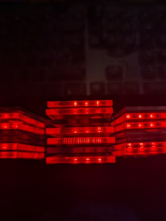

  • hifromkatie
    hifromkatie over 2 years ago in reply to beacon_dave
    Sorry, just realised this comment didn't post on Friday due to an issue with the picture. There isn't any noticeable light spill between the acrylic, the slots go all the way down to the pcb for each slot, like your suggestion.
    It's quite hard to capture it in a photo, as there's some reflection surface to surface, I need to play with colours and brightness to see what combination looks the best.image
