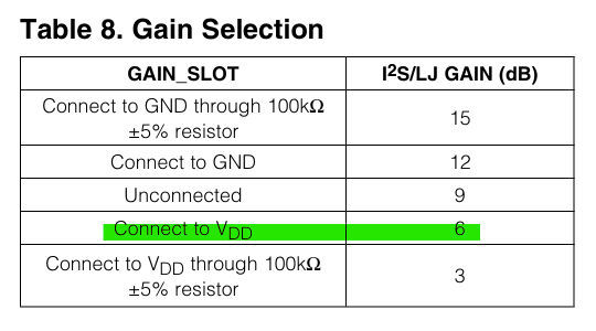

  • AlaskaNick
    AlaskaNick 10 months ago in reply to beacon_dave
    I got the sound to work!!!  But yes, it isn't that loud.  So if I understand your Table 8.  If I connect/route the 3v3 to the gain, I should get a louder volume?
    As yo can tell i am not fluent in Arduino.  Will you be adding other sound effects?  I was thinking of a random "By your command"
  • beacon_dave
    beacon_dave 10 months ago in reply to AlaskaNick
    "...So if I understand your Table 8.  If I connect/route the 3v3 to the gain, I should get a louder volume?..."
    The GAIN pin should already be connected to Vin ( 3V3 ) via the red wire.
    Try disconnecting GAIN from 3V3 to see if you get an improvement; then connect GAIN to GND. Be careful that you don't short GND and Vin together.
    You could perhaps wire in a multipole switch with the common connected to the GAIN pin to allow you to easily select between the various options. You will need 2x 100k resistors.

  • AlaskaNick
    Attaching it to the GND did make it louder.  It's not like a KISS concert but louder than what it was before.  I see the resources with the sound files in it.  Could you direct me to a site that will teach me a little about combining two json files
  • beacon_dave
    "...Attaching it to the GND did make it louder.  It's not like a KISS concert but louder than what it was before..."
    Looks like you get another 3dB yet if you connect to GND via a 100k resistor.
