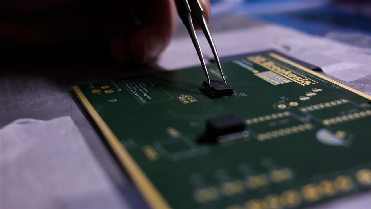

Modern microcontroller: ATtiny3226
The original MK4 board uses an ATmega328P, like an Arduino Uno, a reliable platform years ago, but increasingly obsolete. Clem migrated all firmware to an ATtiny3226, a modern UPDI-programmable chip that’s faster, doesn’t need an external crystal, and is easier to source. That involved remapping every pin via the MegaTinyCore framework and stripping out I²C-dependent code. As Clem notes, leaving in unused I²C routines caused the original firmware to “actively search for those devices on startup,” and stall if it didn’t find them. The new build avoids that, simplifying startup and reducing points of failure.
Quieter, cooler drivers: TMC2209
To replace the older DRV8825/A4988-style drivers, Clem installs TMC2209 stepper drivers. These run cooler and with less noise. Because TMC2209 modules depend on a stable logic voltage rail to detect their reference voltage at boot, Clem adds Schottky diodes to ensure logic voltage comes up before motor power, preventing issues such as mistaken UART mode or mis-detection. As Clem puts it: “This makes sure that the chip can automatically detect its voltage reference level and then goes into read mode.”

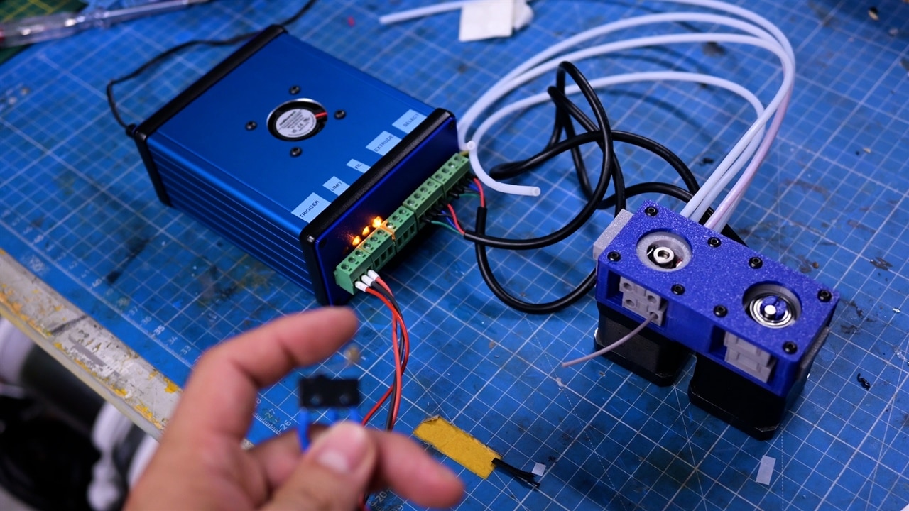

Thermistor-monitored cooling
Stepper drivers and an enclosed chassis can build up heat, so Clem adds a thermistor circuit feeding a PWM-controlled fan. The thermistor forms a voltage divider connected to an analog pin; firmware reads its resistance (using the Beta curve) and, if temperature exceeds the threshold (30 °C in initial tests), triggers the fan via a MOSFET. During testing he observes: “If I touch the NTC… the fan will engage.” He also corrected a MOSFET pin orientation issue caused by a footprint error — a small but important fix.
Visual feedback via LEDs
One drawback of the original MK4 is lack of clear feedback about which filament channel is active. Clem solves this by adding a row of LEDs mounted along the enclosure. Instead of manually writing LED-toggle code all over the firmware, he implements a small helper function.
That means whenever the original firmware would display a status message (e.g. on a small screen or serial console), the remixed version now lights up the corresponding number of LEDs. As Clem asks: “Do you remember still on which extruder this thing now is?” The LEDs give immediate, visible feedback.

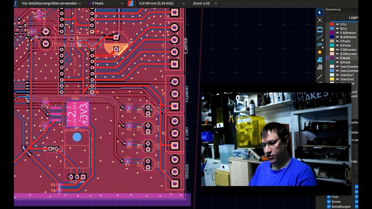

PCB layout for hand-assembly
To make the project accessible for DIYers, Clem redesigned the board layout. He replaced proprietary connectors with standard screw-terminals or headers, placed all connectors along board edges for easy access, and sized the board to slide into a standard Hammond 1455 aluminium enclosure. He even added custom 3D-printed end plates for tidy cable routing and airflow. As he says: “My version is made so you at home can assemble it yourself with just a soldering iron.”

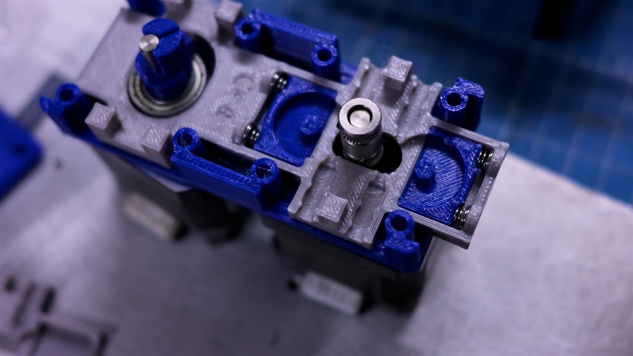

Mechanical side remains unchanged, and why that matters
Because the mechanical changer works reliably, Clem decided not to alter it. The lever system, springs and bearings remain exactly as in the original MK4 design. That means all prior knowledge, print profiles and G-code workflows remain valid. The community still sources the same springs and bearings, though Clem cautions that obtaining some parts may be slightly harder in Europe than in the US. With some patience, builders can still assemble a fully functioning mechanical changer that swaps up to four filaments in sequence.

  • The hardware runs on 12 V, either from a separate power supply or the printer’s PSU. Clem estimates that ~1.5 A is enough for the system. “1.5 amps is plenty enough to run this,” he says.
  • The printer’s print job flow doesn’t change. The slicer or pre-processor inserts standard G-code moves so the print-head hits the actuator switch at the right time. The firmware selects the correct filament channel (based on how long the button was pressed) and runs the load/unload sequence.
  • During testing, switching colours and loading filament worked exactly like the original – but with added benefits: quieter drivers, active cooling, and instant visible feedback via LEDs.
