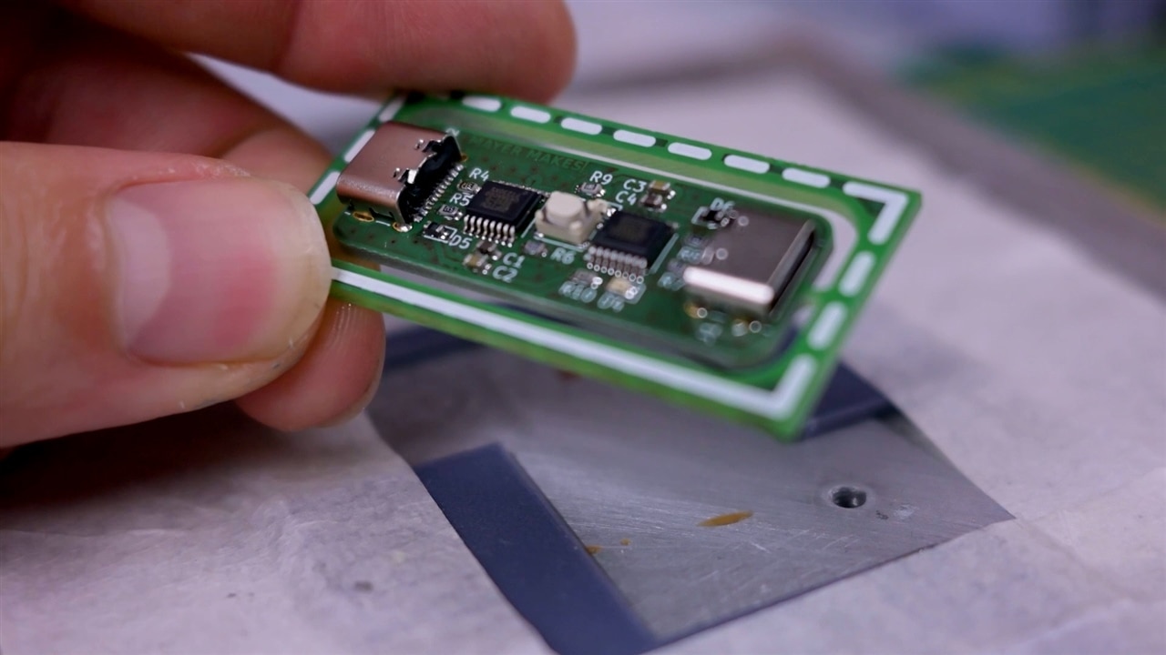

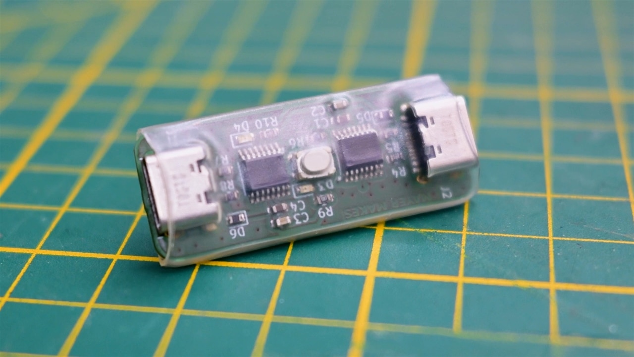

Clem introduces the "Blooper", USB Looper, a modern null-modem style tool for UART debugging, device emulation and file transfer without a network. See how it logs serial data, enables full-duplex chat between computers, and safely connects two USB hosts.
Watch Clem Build the Blooper
Some tools begin as personal workflow helpers and quietly become essential to multiple projects. Clem’s USB Looper. nicknamed the “Blooper”, clearly falls into that category. What started as a practical debugging aid has grown into a fully documented, open-source hardware tool designed to solve real development problems around UART, USB and device emulation. Of course, it comes Clem endorsed:
“This tool has saved so many projects… and guess what? I made it myself.”
The Blooper is best understood as a modern reinterpretation of the classic null modem cable, but built for today’s USB-centric workflows and development environments.
What the Blooper Actually Does

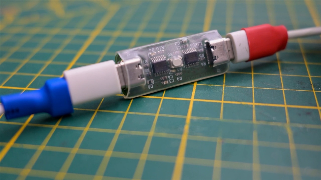

At first glance, the Blooper appears simple: a small device with two USB-C ports. Internally, however, it enables something surprisingly powerful. When connected, the computer sees two independent USB serial devices.
As Clem explains:
“The blooper appears as two independent devices… they both just talk to each other.”
This means a single computer can communicate with itself as if it were talking to an external embedded system. From the OS perspective, the data looks like it is coming from another device entirely, even though it’s looped back through the hardware.
This hardware loop-back is central to why the tool exists. While software loop-back can be simulated, Clem points out the limitations:
“You could emulate this in software, but the setup is not as easy… and I don’t think it works on any computer. And this thing does.”
This reliability and portability is the key difference.

Internally, the Blooper converts USB to UART on both sides. The result is two hosts communicating directly, bypassing traditional USB host-device constraints.
This is what allows two computers, or even one computer with two terminals, to chat over a single cable.

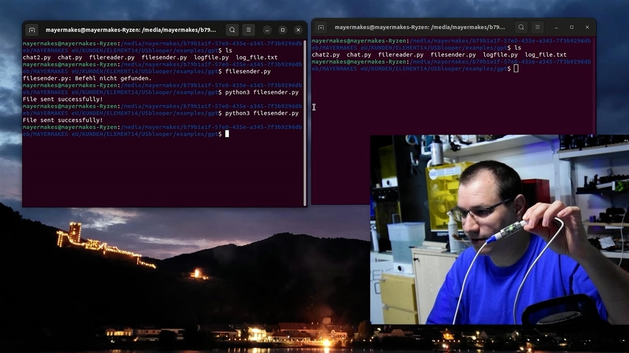

Transferring Files Without a Network
Another demonstration recreates a classic use case: transferring files without network access.
Clem explains the relevance:
“While transferring data without a network is not as common today… this can still be useful in air-gapped systems.”
The Python tools behind this are filesender.py and filereader.py.
Sending a file is straightforward:
with open('log_file.txt', 'r') as file:
    data = file.read()
ser.write(data.encode())
Receiving and saving the data uses continuous serial reads:
incoming_data = ser.read(ser.in_waiting).decode()
file.write(incoming_data)
These scripts mirror how firmware is often uploaded to embedded systems.
Clem explicitly connects the dots:
“This is the same way that you would upload firmware over serial… or configure industrial machinery.”
Hardware Design Choices That Make It Reliable
The transcript adds substantial technical depth beyond the original write-up, especially around the hardware design decisions.
One of the most important details is the use of FTDI USB-UART chips:
“They always enumerate perfectly… they don’t need any external crystals. This has to be reliable and bootable at any time.”
This is a key engineering decision: the Blooper is meant to be a tool, not an experiment. Reliability takes priority over cost.

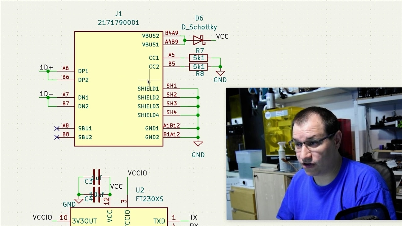

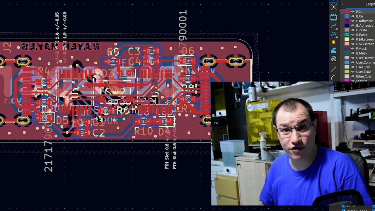

Other critical hardware details include:
• USB-C CC pull-downs (5.1kΩ) to ensure correct power negotiation
• Schottky diode to prevent reverse powering
• Ground stitching vias to prevent cross-talk
• Shared reset circuit with pull-up resistor
• Dual LED indicators for traffic direction
Clem emphasises safety:
“If you don’t do that, you get weird behaviour… and this could damage the port.”
These considerations ensure the device is safe to connect between two computers, something normally discouraged with USB-A-to-USB-A cables.

Clem notes the challenges of USB-C connectors:
“Be aware that USB-C ports that have pins underneath them… might be really hard to rework.”
He deliberately chose USB-C connectors limited to USB 2.0 to simplify assembly and avoid unnecessary complexity.

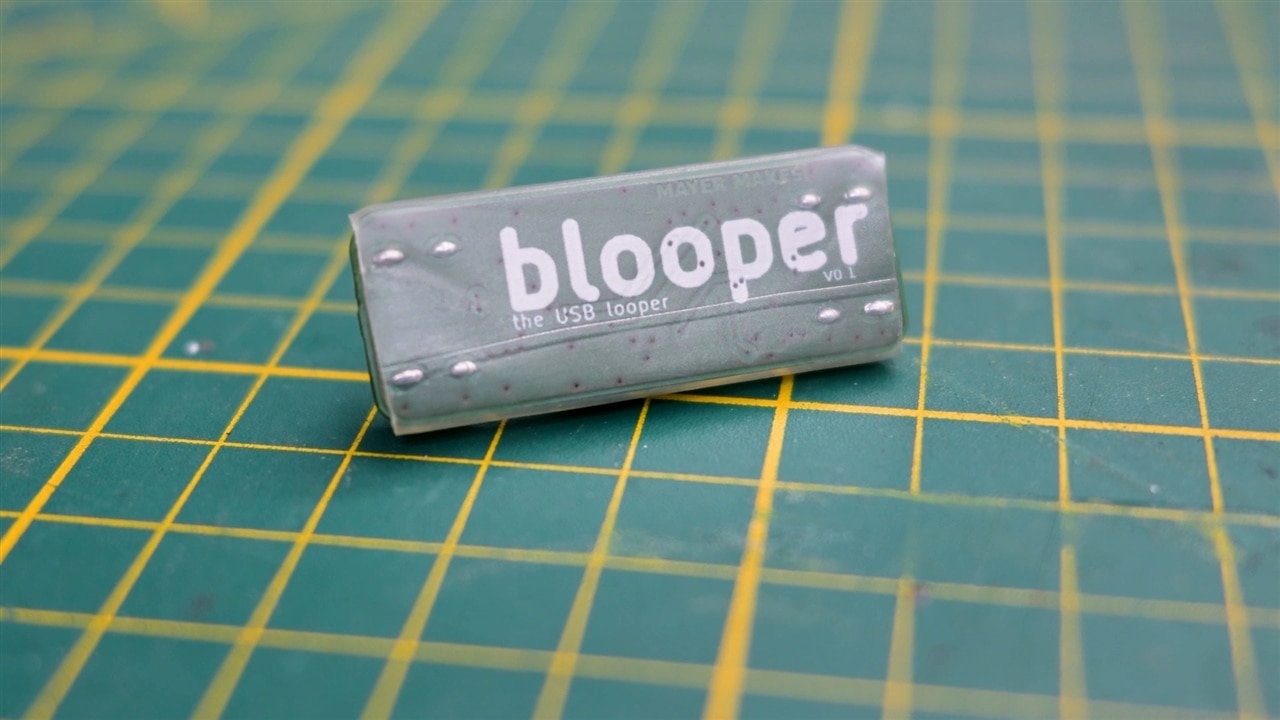

For enclosure, he chose a pragmatic approach:
“Heat shrink is the absolute easiest way to make a case… it’s completely functional and compliant.”
This reinforces the project’s focus on practicality.
