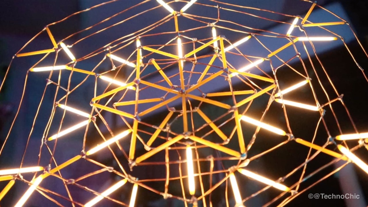

The snowflake is made up of eight separate groups of LED filament, each forming a visible section of the overall design. Electrically, each group is bundled together and connected to a single wire. This means the sculpture is animated by sections rather than by individual LEDs.
Before connecting anything to a micro:bit, Natasha powered the LED groups directly to see how they looked when switched on in different combinations. This simple step made a big difference later on. By turning sections on and off by hand, it became much easier to see which parts of the snowflake naturally stood out and which worked better as supporting elements.

The original plan was to fade all of the LED groups smoothly using analogue PWM outputs. With the number of pins available on the micro:bit, this seemed like it should work. In practice, only a few groups would fade correctly at the same time.
After some troubleshooting, the reason became clear. Even though many micro:bit pins appear to support PWM, only three analogue outputs can be used at once. Trying to use more than that causes the others to stop working.
At that point, there was a decision to make. Switching to a different microcontroller would have solved the problem, but it would also have meant rethinking parts that had already been chosen for this build, including the edge connector and mounting method. Instead, Natasha chose to work within the limitation.
By dropping the idea of smooth fades and focusing on digital on and off animation, the sculpture actually started to look better. The sharper transitions suited the snowflake’s graphic shape, and the animations felt clearer and more intentional. What started as a frustration ended up defining the final look of the piece.

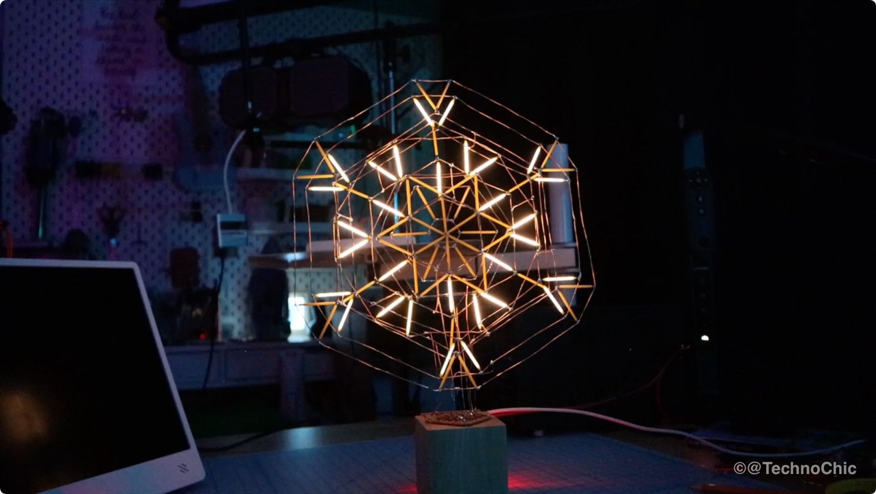

Once the pin assignments and animation approach were decided, the sculpture was soldered permanently to a micro:bit edge connector. Each copper wire was bent into a small hook, threaded through the connector holes, and soldered securely. Excess wire was trimmed away to keep everything neat.
Mounting the connector brought its own challenges. Because it sat close to the edge of the wooden block, machine screws were used instead of wood screws to avoid damaging the edge. The micro:bit was mounted upside down on the back of the block, keeping it out of sight while still easy to access.
One last practical issue came up late in the build. With the micro:bit mounted so close to the block, a standard USB cable would not fit. A USB turnaround adapter solved the problem, redirecting the cable and switching the connection to USB‑C at the same time. It is a small part, but without it the whole mounting approach would have needed to change.

For interactivity, Natasha used the micro:bit’s built‑in microphone. This kept the project simple while still allowing the snowflake to respond to its surroundings. Loud sounds trigger bursts of animation, making the sculpture react to voices, laughter, and music.
Using analogue volume levels was tested briefly, but the results did not look right. Differences in brightness between layers felt accidental rather than deliberate, which reinforced the decision to stick with bold digital animation.
In its finished form, the animated snowflake feels playful and responsive. It invites interaction and rewards experimentation, working equally well as a decorative object, a light sculpture, and something to simply play with.
