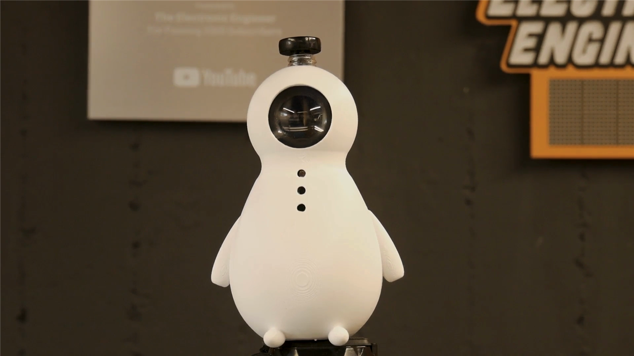

Mark set out to create something that sits somewhere between a desk companion, environmental monitor, and electronic novelty. The result is what he calls a "Desk Pet Minion" a desktop gadget built around an ESP32 that watches the room through an animated eye, measures environmental conditions, listens for noise, produces sound effects, and even emits fog to express its displeasure.
What started as a fun desk ornament quickly became a surprisingly feature-rich embedded project. Along the way, Mark designed custom hardware, assembled a dedicated PCB, integrated multiple sensors and peripherals, and worked through a significant hardware design issue that required an unexpected mid-build correction.
The finished device combines environmental sensing, audio processing, display graphics, and fog generation into a single desktop companion with plenty of room for future expansion.
The Concept
At its core, the project is designed to bring a little personality to the workspace.
The animated eye continuously moves and watches its surroundings, giving the impression that the device is paying attention to activity around the desk. Combined with environmental sensing and sound detection, the minion becomes more than a static display piece.
As Mark explains:
"It displays that well, mimic eye movement so it can stare at you while you're sitting at your desk."
The eye is only part of the personality. A built-in humidifier creates visible fog effects, allowing the minion to react to events and express different moods. Loud noises in the office can trigger both sound and smoke effects, turning the device into a humorous commentary on workplace volume levels.
The project also includes temperature and humidity monitoring, audio playback capabilities, microphone input, and a display mode that functions as a real-time spectrum analyser.
Future expansion was also part of the design from the beginning.
"In the future I might even update it to function as a radio because I'm using an ESP32 and it has onboard Wi-Fi."
That choice of microcontroller leaves plenty of processing power and connectivity available for additional features.

Rather than wiring everything together on perfboard, Mark designed a dedicated PCB specifically for the enclosure.
The custom board serves several purposes:
  • Reduces wiring complexity
  • Improves assembly
  • Ensures all components fit inside the minion housing
  • Provides dedicated connections for audio, sensing, and display hardware
  • Creates a cleaner final installation
The PCB accommodates the ESP32 module, display, microphone, humidity sensor, audio circuitry, power distribution, and humidifier control circuitry.
A dedicated switching circuit drives the humidifier assembly, allowing the ESP32 to enable or disable fog generation under software control.
The humidifier itself consists of a commercially available ultrasonic fog generator module paired with a small water reservoir. A test tube serves as the water container and fits neatly into the enclosure.
The arrangement provides a simple and effective way of generating visible fog without requiring any custom ultrasonic hardware design.

The most entertaining behaviour appears once everything is assembled. The ultrasonic humidifier produces visible fog while the eye tracks movement and the microphone listens to the environment. At its current stage, excessive noise acts as a trigger condition. As Mark describes:
"If your colleagues are too loud in your office then this device will basically say 'Psh'."
The combination of sound effects and fog generation gives the minion a surprisingly expressive personality.
Of course, the development process wasn't entirely smoke-free. During testing, an accidental short circuit generated some very real smoke from the electronics.
Mark jokes:
"I might have jinxed it a bit by trying to add artificial smoke."
Fortunately the issue was corrected and the project survived to reach its final form. Beyond environmental monitoring and animated eye graphics, the display can also switch into a spectrum analyser. This mode makes direct use of the I2S microphone and frequency processing code to create a visual representation of incoming audio.
